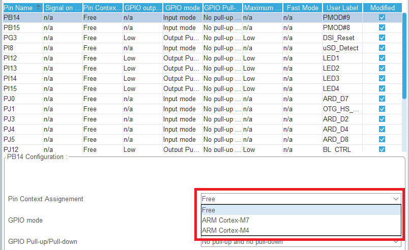

Sorry, I did not explore fully the GPIO in CubeMX for dual core like the H747.
You may need to assign which core will need to init it.

Guru
GPIO initialization for various peripherals is generally within the HAL_*_MspInit functions which are placed in "stm32h7xx_hal_mspinit.c". The code you've linked just enables the clocks (and MCO).
> I also find that most Init are in CM4 src, why is that so?
As for why they're in CM4 instead of CM7, just depends which core you've assigned them to in CubeMX.

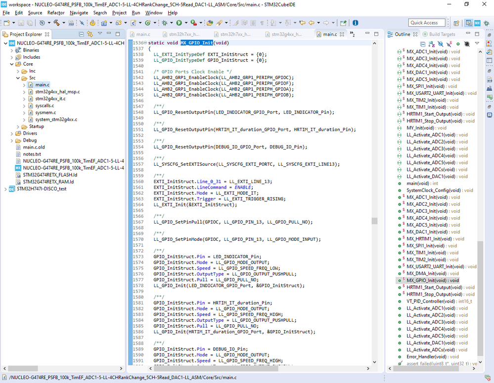

Generally the GPIO init is in main.c from my previous projects as shown below.

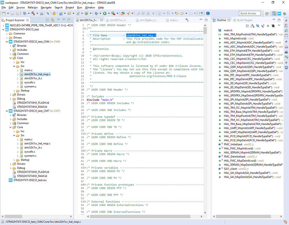

The "stm32h7xx_hal_msp.c" does not contain GPIO init.
Also you may notice that stm32h7xx_hal_msp.c and stm32h7xx_it.c is under M4 folder as shown below. Must be typo during code generation.

Maybe I misunderstood the question. MX_GPIO_Init is indeed in main.c.
Each core only initializes the peripherals/pins it uses. I would expect your CM7 code only uses pins within the 3 GPIO ports that are started in MX_GPIO_Init.
Why would that be a typo? Both files are present in both of the cores, although their contents will not be identical.
