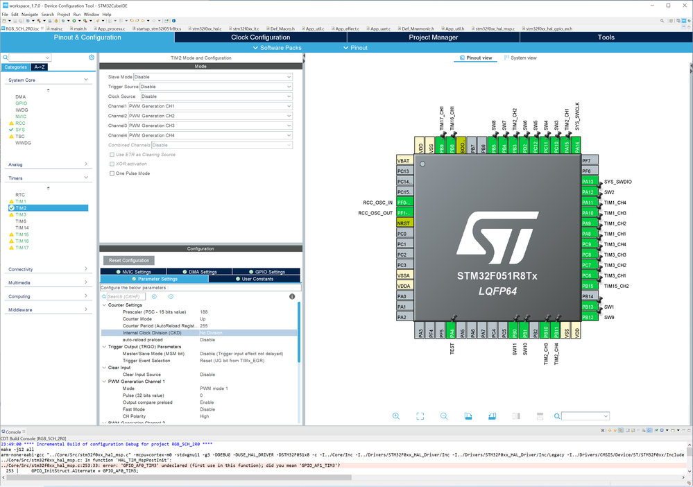

STM32CubeIDE error?
SMj.1

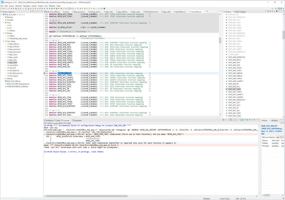

0693W00000GXHqsQAH.png0693W00000GXHrHQAX.png0693W00000GXHpRQAX.pngUse TIM3 PWM --> GPIO_AF0_TIM3
but #define GPIO_AF1_TIM3
Error??

Actually you're right, the build problem occurs when remapping TIM3_CH3 function to a pin other than PB0 pin (PC8) .
In fact, backing to the STM32F051 Data Sheet, TIM3_CH3 is AF1:TIM3 Alternate Function selected through GPIOB_AFR registers for port B:
0693W00000GY4tMQAT.pngWith this being said, this problem is reported internally to be fixed. I'll keep you posted with updates.

This issue is fixed with the latest release of STM32CubeMX-6.3.0.
So, please make sure to use this release, then keep me informed about your update.

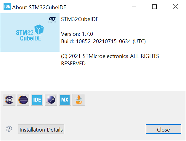

So, why does the error occur when I generate the code in STM32CubeIDE 1.7.0?
So, why does the error occur when I generate the code in STM32CubeIDE 1.7.0? 2021년 11월 12�?� (금) 오후 10:04, ST Community 님�?� 작성:
The CubeIDE is integrated CubeMX. So you generate your project through cubeMx.

STM32F051R8T6 PC6 ------> TIM3_CH1 PC7 ------> TIM3_CH2 PC8 ------> TIM3_CH3 PC9 ------> TIM3_CH4 ../Core/Src/stm32f0xx_hal_msp.c: In function 'HAL_TIM_MspPostInit': ../Core/Src/stm32f0xx_hal_msp.c:131:33: error: 'GPIO_AF0_TIM3' undeclared (first use in this function); did you mean 'GPIO_AF1_TIM3'? 131 | GPIO_InitStruct.Alternate = GPIO_AF0_TIM3; | ^~~~~~~~~~~~~ | GPIO_AF1_TIM3 ../Core/Src/stm32f0xx_hal_msp.c:131:33: note: each undeclared identifier is reported only once for each function it appears in 2021년 11월 16�?� (화) 오후 11:57, ST Community 님�?� 작성:

You are right, I reproduced the same issue with CubeMx 6.3.
I will escalate this issue internally to CubeMx team for fix.
