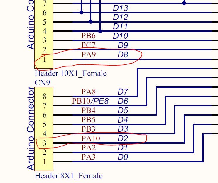

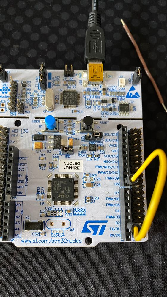

I have a jumper wire going from D8 to D2 that would connect the UART RX and TX pins.
And I'm using RealTerm to monitor the output and I am getting all the values of the buffer_tx[] being output on there.

did you check with an oscilloscope that what you got on TX pins you have it on RX Pins on the corresponding GPIO ? Which product is targeted (package as well) and which tutorial are you running ?

It looks like the link to the reception in not good. are you well handling the pin affectation for RX and TX into the stm32f4xx_hal_msp.c files as well as the correct alternate function number set ?

I do not see at first glance something wrong in your code... Are you sure about your connection (physical connection to connect Tx to RX (Pin 3 CN9 D2 connected to D8 pin 1 CN5) ? If yes, if you put a breakpoint into the RX callback and TX callback, are you able to stop to one of the breakpoint (I suppose yes, because you said that you are able to validate that TX is well running on the output sending the buffer_tx) ?
Below is the datasheet that I referenced to make the connection with the yellow jumper cable (which I tested with a continuity check to keep my sanity which checks out fine)
When I placed both a while(1) loop and breakpoints that both RX/TX call back function calls, neither of them are being triggered and are being 'skipped over' when I'm 'Stepping through' the entire code in Debug mode
