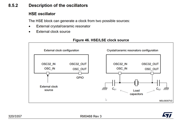

The manual RM0468 is clear:

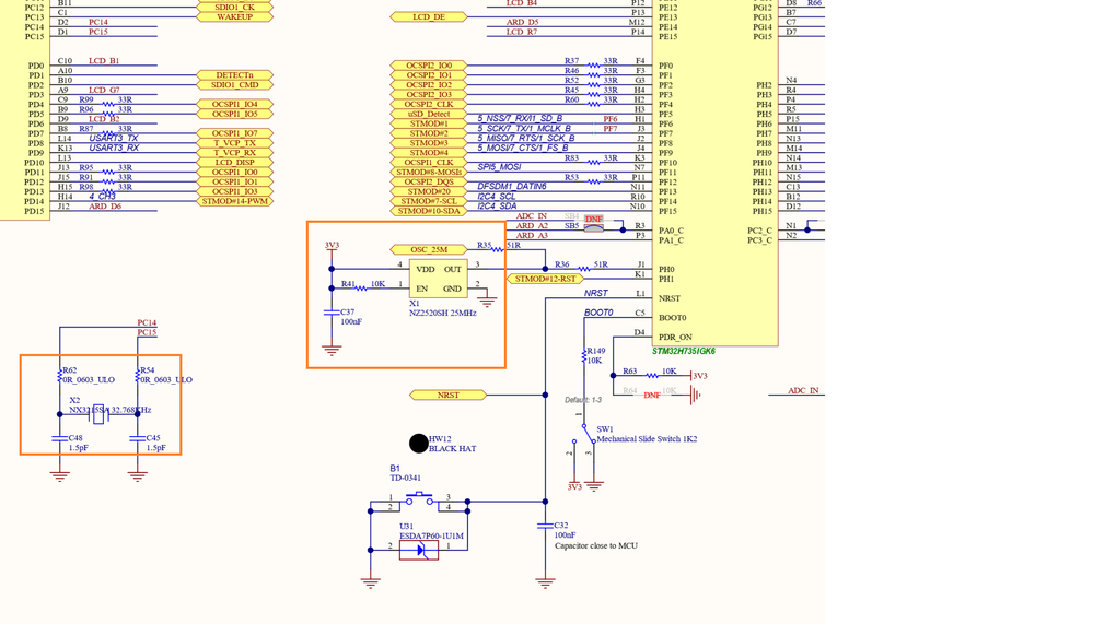

0693W00000QM6E2QAL.pngThe schematic of the STM32H735G-DK kit:

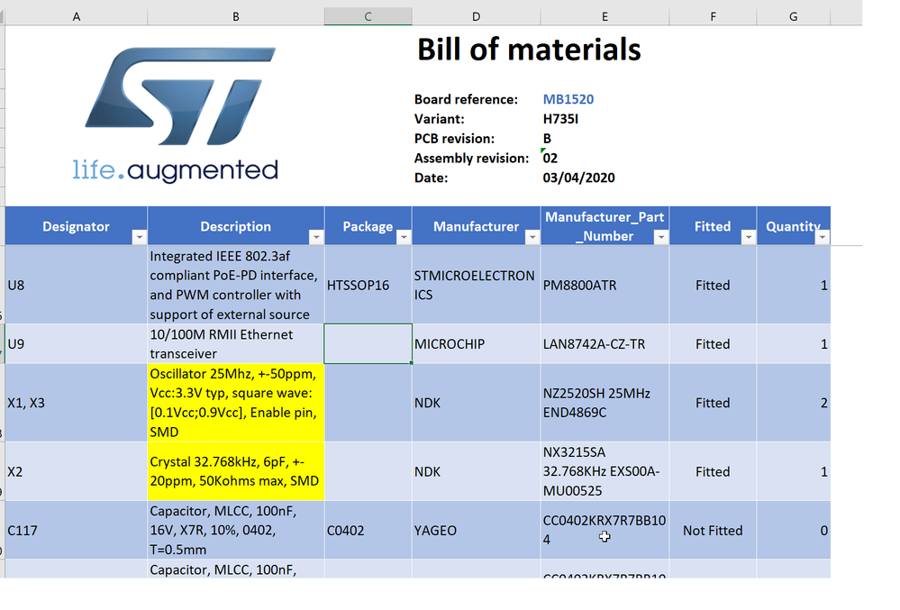

0693W00000QM6AFQA1.png X2 is a crystal, X1 is an oscillator:
BOM says the same:

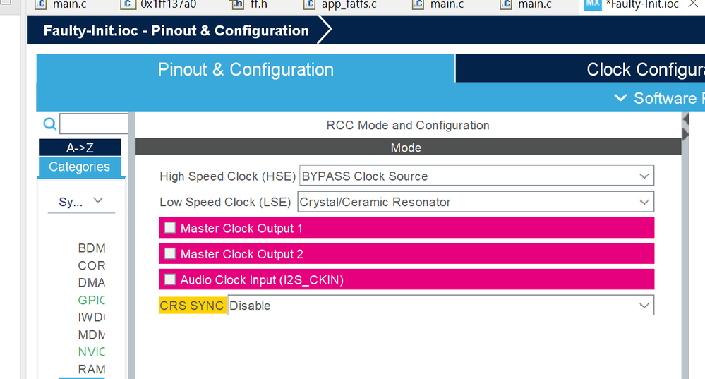

0693W00000QM6AZQA1.pngBut STM32CubeIDE initialized as per the board:

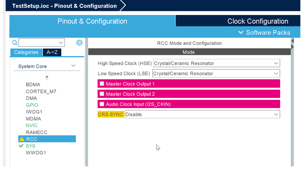

0693W00000QM6AtQAL.pngAnd should be: (IMHO)
0693W00000QM6B8QAL.pngMy question: Is my analysis correct or did I overlook something?
