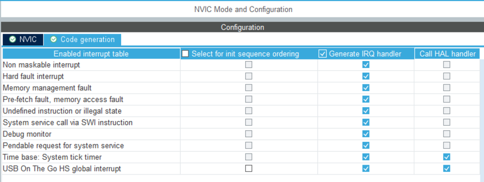

Mike_ST
August 25, 2021
Please, check that interrupt for USB IP is activated.
I think this was an issue before.
Otherwise, have you tried the examples that are included in the STM32 firmware packages ?

Mike_ST
August 26, 2021
>> I have tried the examples in the packages.
Do they work ?
Talking about the following interrupt "USB On The GO HS" here:

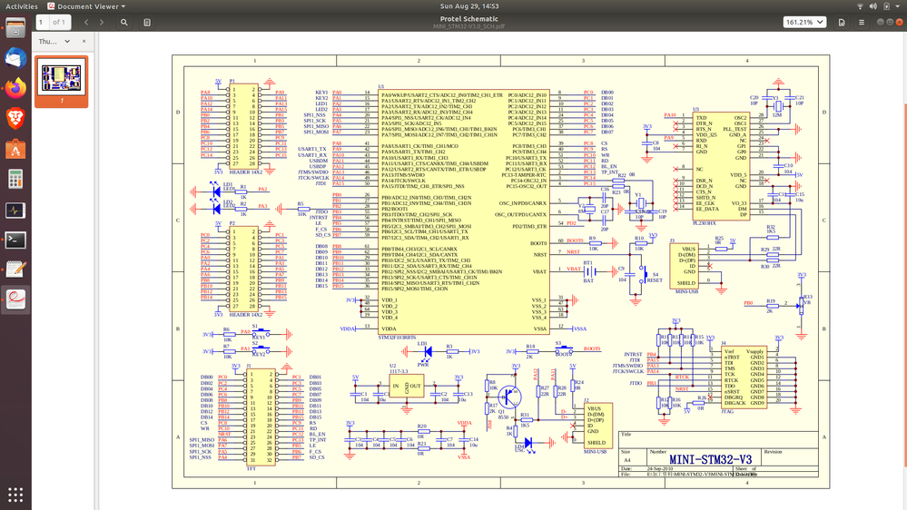

I am posting here in detail.
STM32CubeIDE v1.6.1
Firmware Package Name and Version: STM32Cube FW_F1 v1.8.4
OS: Ubuntu 18.04.5 LTS \n \l
HW: STM32F103RBT6
It is not even enumerating. The .hex file provided by the board manufacturer enumerates as USB HID, but when I create a project in STM32CubeIDE / STm32CubeMX, it does not even enumerate.
Also tired on STM32F429ZI Discovery board, STM32F746 Discovery board, none working.
Attached STM32CubeIDE project.
Mike_ST
August 30, 2021
Do you manage PD2 in your software?
Where do you initialize PA11 and PA12 ?
Please look at usbd_conf.c from the STM32F103RB-Nucleo example
User16782158065171037550
September 4, 2021
Hi Mike_ST,
I got it working on STM32F103RB, the PD2 was not set correctly. I am not able to get it working on STM32F429 and STM32F746 discovery board, WIP.
Thanks all for your help and suggestions.
