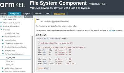

Seems like I need to do something like this for kiel5 to resolve the issue.
