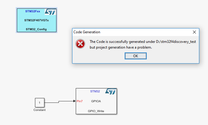

1. A simple Simulink setup for a normal build:
When building this simple model, the above error occurs.

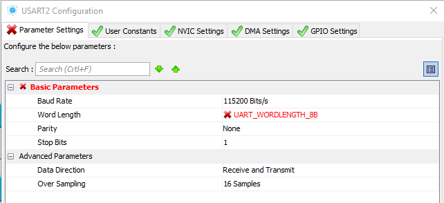

When the configuration for STM32CubeMX opens, the uart port has the following configuration error:
The correct keyword according to the program should be WORDLENTH_8B, not UART_WORDLENGTH_8B. This has to be fixed manually every time and prevents the project generation from working when the call to CubeMX is hidden.

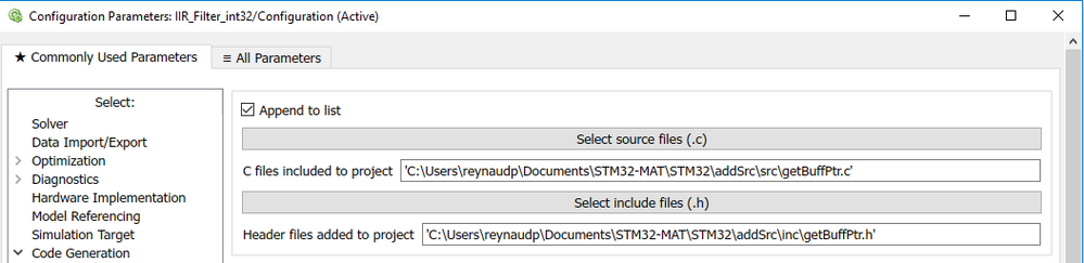

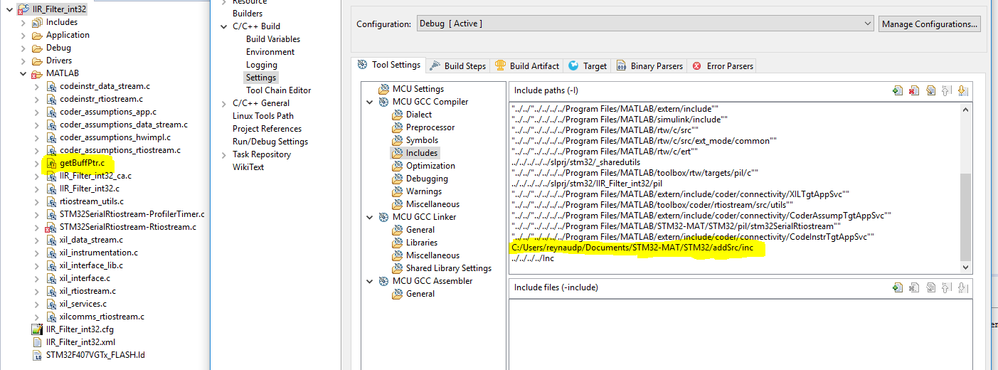

3. If the issue above is fixed manually and the project is generated and opened with SW4STM32, the compilation errors out with missing files. This is due to the include paths being messed up with the quotes:
These can be fixed manually but then it errors out because there is an extra file which has no rule for make:
This file seems to be included by accident and the include itself is some hardcoded path to a username (not mine). The file and include can be deleted to make the compilation finally succeed.

Regarding 1 :
Generally it is problems of access rights to files.
For example, if the file is locked during opening and you are trying to write it again.
Another point of attention, there is a bug in the 4.20 which makes the default values are not always good, especially for the generation of the code of the clock, a 4.20.1 is prepared.
Regarding 2:
Sorry, STM32CubeMx keyword has changed. It will be integrated for next STM32-MAT/TARGET release.
Regarding 3:
It looks strange that getBuffPtr is included to project. Can you please verify that it is not included from Project Configuration parameters window > Code Generation >STM32 Project Files ?
Regarding quotes, I will give you answer asap.

Regarding 1:
I got the project generation working, my mistakes were that the Simulink file and CubeMX config file were not in the same locations and that I didn't specify any toolchain during CubeMX config file generation (I was used to the PIL setup where a toolchain would be specified in a separate dialog from Simulink).

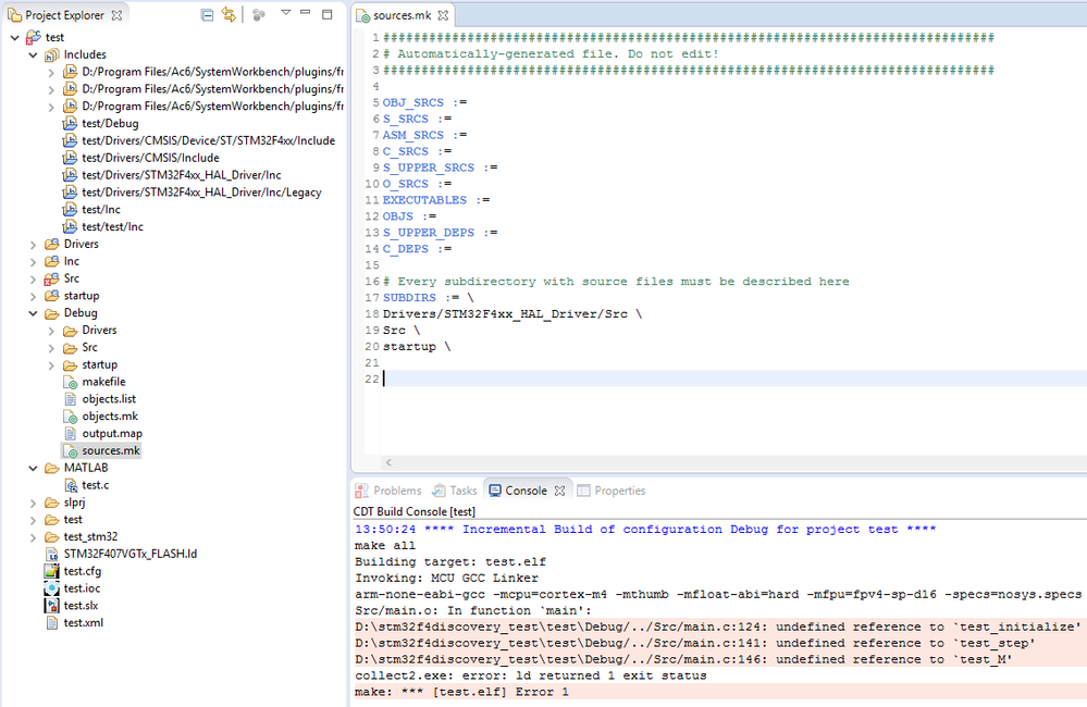

Now a new problem arises. In SW4STM32, the automatic makefile generation fails to include the MATLAB folder so the compilation fails once again:
A workaround for this is moving the test.c file to the <project root>/Src folder next to main.c or creating the makefile manually. Do you have any idea why this folder isn't included in the makefiles?
EDIT: It seems that deselecting '' Generate Under Root'' from the CubeMX project settings screen solves this issue (This option is enabled by default!!). This also makes the folder structure in the project explorer much nicer. I also tested some other toolchains. Atollic TrueSTUDIO (evaluation version) also suffers from an issue like this (some files are missing in the project file explorer and compiling fails. Both TrueSTUDIO and SW4STM32 are eclipse based so not really unexpected). Also here, deselecting ''Generate Under Root'' solves this problem. Keil MDK-ARM v5 (evaluation version) and IAR EWARM (evaluation version) work just fine.

Regarding 3:

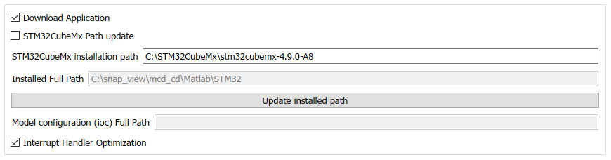

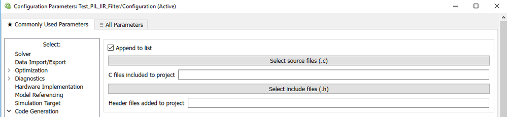

I found the source of the include issue. These are located in the configuration section of ''IIR_Filter_int32.mdl'' and, not in the configuration of ''Test_PIL_IIR_Filter.mdl'', which is the main file and thus it was not clear where these includes were coming from.
IIR_Filter_int32.mdl configuration:
Test_PIL_IIR_Filter.mdl configuration:

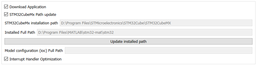

Also, the paths of STM32CubeMX and STM32-MAT are not correct by default, but I guess that does not really matter as we're supposed to update those anyways:
In my case, the correct paths are:
With this, the issue of the misplaced quotes isn't fixed however, only the extra included file path.

Sorry for the remaining getBuff in
IIR_Filter_int32.mdl, I will remove it.
Both settings for principal model and included (called) one should be the same, you should get an error if not.

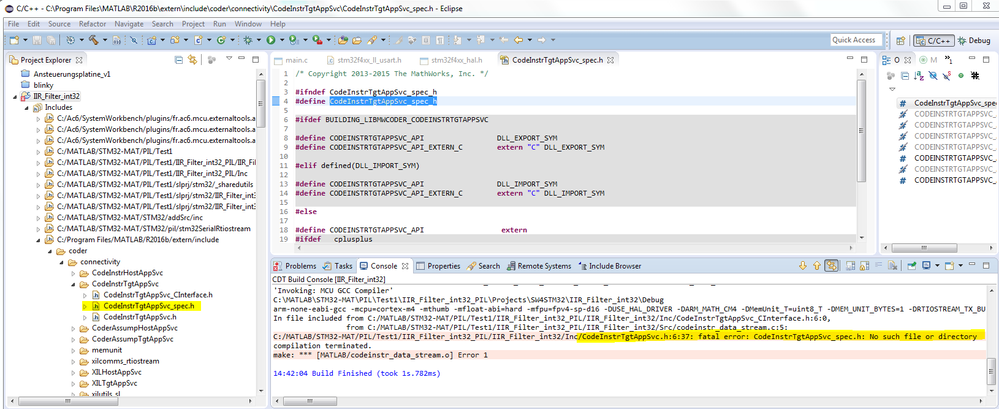

Hey guys,
thank you for the guidance so far! I have exactly the same issues. I'm using the newest versions of all programs (Matlab 2016B with all necessary addons, CubeMX 4.20.1, FW_F4_V.1.15.0 package  and SW4STM32). When I try to compile the PIL Test from the hands on, I cannot build the project.
- When I manually move the .ioc file to the root folder with the Simulink file, the project compiles but it does not have any bindings with the generated code from Simulink.
- When not moving the .ioc file, I get dozens of errors from the build process. Most of them concern the unresolved includes coming with the quotes. After correcting that by hand, I still get the errors. It's strange, because the missing files are now in the include folder of the project - see below.
I have almost no experience with eclipse yet, so I don't know if that's a beginners mistake. I tried clean project, rebuild index, freshen files etc. but with no success.
Sebastiaan, would you mind writing step by step instructions how you got the generated code to work on your Discovery board using SW4STM32? I'm completely stuck and don't know what else to try.
