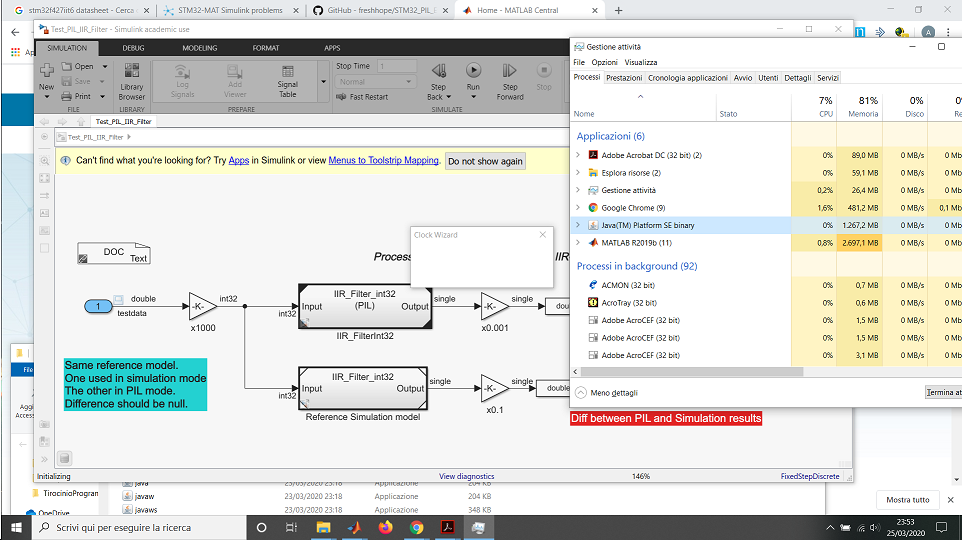

i'm Antonio and few week ago i've start to learn simulink and PIL simulation.
I tring to test the IIR-Filter project from STM32_MAT-TARGET on my stm32f429i-DISK1 board with sw4stm32 toolchain but i've some problems ( used many time all the steps of STM32_MAT-TARGET_HandsOn_v1_0.pdf) but for me the biggest issue is the freezing when simulink try to open stm32cubemx (probably at clockwizard start).
Java not work and only after i kill the process stmCube work, but without the settings...
i've uninstall java with the relative tool , clean registry, reinstalled, killed processes that can use java, but nothing have work...
Someone can help me?
Someone have had the same problem
My system is:
Win10 home
java Version 8 Update 241 /64bit
Matlab R2019b
Stm32cubemx v. 5.6.0
Thanks!
toniospritz
For all the people that use SW4STM32 toolchain, maybe i've found a solution for the error: The timeout of 5 seconds for receiving data from the rtiostream interface has been exceeded.
System Workbench STM32 open auomatically a connection on the serial port with the board. Do you must disconnect the link with the build-in console, and only after burn the application on the board.
For the java freezing issue the only solution is kill java and set manually the clock and the other parameters.

i don't know how is possible, but the issue with java and cubemx is come back! :loudly_crying_face: stm32cubemx stop run on the clock wizard.
For the second question he heap size is set ad default valure at 0x200. How i can check the polling on the rx path?
the uart configuration i think is ok, i've set the usart1 (pin PA10 for the RX and Pa09 for the Tx) i've try to load the usart ioc from C:\MATLAB\STM32-MAT\STM32\STM32demos\Test\USART\F429I-Discovery\USART_1_Receive and have the same iostream error message...
toniospritz
