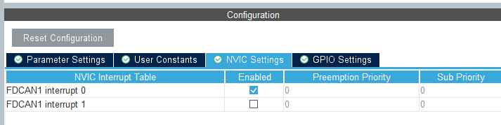

i'm trying to set up a new project with CAN in Interrupt mode. Therefor i generate a project with stm32cubemx and enabled the interrupt 0 for fdcan1 and also in the NVIC-settings the Interrupt is enabled:0693W00000AN0JsQAL.pngIn polling mode, i can receive Frames and got no problems. When i try the to use the NVIC, the ISR-Adress is wrong an it don't jump to the generated "FDCAN1_IT0_IRQHandler". The Controller jumps to an undefined Adress:0693W00000AN0JxQAL.png

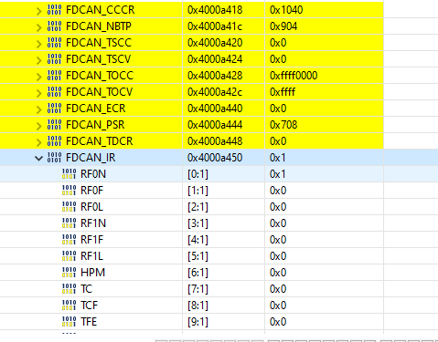

Up there it worked. When i send a canframe from an external system i see an interrupt pending.
0693W00000ANAFRQA5.pngBut the controller don't enter the generated function from the cubemx

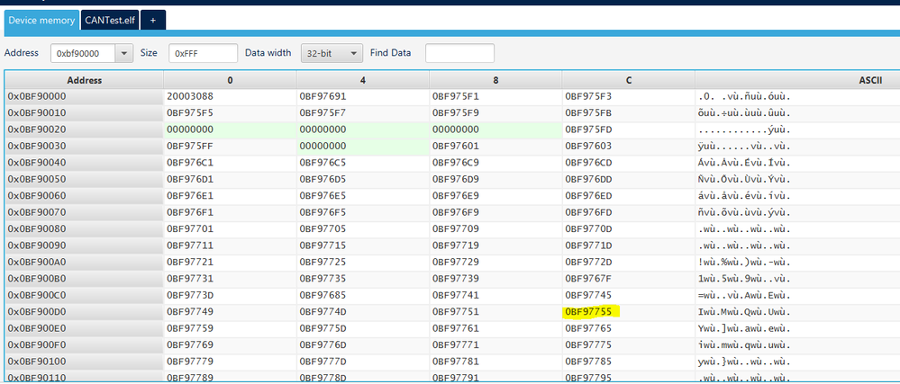

My guess is that something is wrong with the config of the interrupt vector table. VTOR gives me the baseaddress of the tabel, thats 0xBF90000. In the register starting from 0xBF90010, should be the addresses for the specific interrupt. The CAN ISR is the Block 0xBF900DC and thats not the function for the isr.
0693W00000ANAOxQAP.pngThis address jumps outside the code 0693W00000ANANbQAP.png
It ends up by the error:
Break at address "0xbf97754" with no debug information available, or outside of program code.
