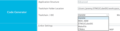

I have installed STM32 CubeMX on a Mac (Apple Silicon) and I get the following error when trying to generate code:
The Eclipse executable launcher was unable to locate its
companion shared library.
Any one come accross this and any idea how to fix?

fabltdAuthor
October 25, 2024
If I change the tool chain from STM32CubeIDE to for example EWARM the error is not present.
