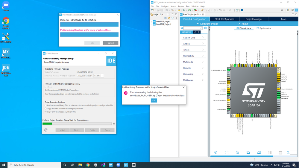

solution: error in stm32cubeMX or (cubeMX inside stm32CubeIDE) for add new Firmware or new patch(offline or online)
‎2020-04-13 6:36 AM
error: cube firmware cannot be installed into repository.
a file or directory with name same already exist.
The cause of this error = old time add firmware and not remove with stm32cubeIDE or stm32cubeMX.(manually removed or uninstalled stm32cubeIDE / Stm32CubeMX before remove firmware with stm32cubeIDE or stm32cubeMX).

After two days of increasing anger (:pouting_face:) due to continuously failing install a new subversion pack (STM32Cube_FW_F1_V1.8.3) this is what I found: the previous folder (STM32Cube_FW_F1_V1.8.0 ) was rewritten but, unfortunately, without changing the folder's name. This is the reason everything worked OK in the installation's beginning (downloading pack, un-zipping and installing) but failed in the end as the software was looking for the un-existing folder STM32Cube_FW_F1_V1.8.3 . To overcome this issue (until STM solve the problem :sleeping_face: ) I had open "C:\Users\my_user_name\STM32Cube\Repository" , and manually modified the folder's name to STM32Cube_FW_F1_V1.8.3 to match the last installed pack name. And ... magic happened!

‎2021-06-18 11:02 AM
I had this frustrating issue on Windows 10 Pro. I solved it by creating a new folder for the repository and changed the repository settings to that new folder.
- Window -> Preferences -> STM32Cube -> Firmware Updater
- Click browse
- In the file explorer, create a new folder and then select it
- Click Apply and Close
- Go to Help -> Manage Embedded Software Packages and install the package you need.
Installation should be successful and you should be able to generate code.
