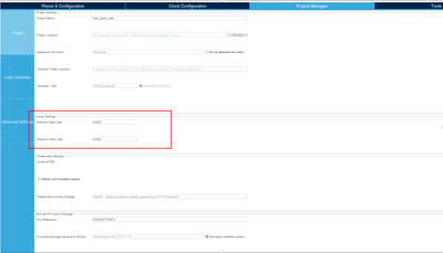

Folks,
I’m grappling with what looks like a low level bug** , and the root cause could be running out of stack space.  At the same time, I’ve got plenty of unused RAM, so I’d like to increase the stack size as a diagnostic measure, and see if the bug goes away*** . In the CubeIDE user guide (UM2906) there’s a mention that heap and stack size are set in the LinkerScript.ld (comments in the code on p. 69).
If I want to change the _Min_Stack_Size , should I edit the LinkerScript.ld file directly?
Or is the LinkerScript.ld file (re)generated by the IDE, and I should make the change through the IDE GUI?
If so then where are these settings?
I couldn't figure it out from the UM2906.  I saw hints that CubeMX had GUI fields settings for stack and heap.

I understand the dilemma, the .LD impacts what the Linker actually builds, but ST for years has nailed the GNU/GCC stack to Top-of-Ram directly via _estack
And then used SP to provide a heap ceiling for _sbrk, ie from end-of-statics to base-of-stack

Hello @Nick Alexeev
In order to change the _Min_Stack_Size and  _Min_Heap_Size  using GUI fields.
just go to  Project manager -->project
Unfortunately, for the meantime, there is a limitation in this option that has been tracked with internal ticket 197963

That doesn't answer the more general question about editing the .ld file.
How should that be managed - especially for things that are not provided in the MX GUI ?
