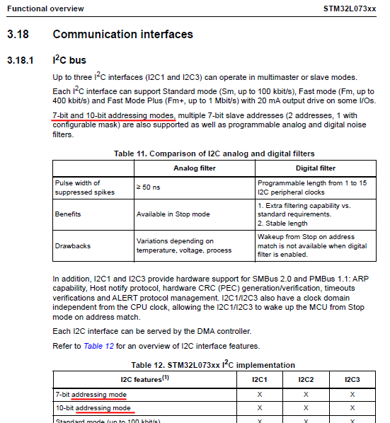

I tried to communicate using I2C function in STM CUBE MX, but the sensor seems to communicate with 13bit... MX only supports 10bit....Please help....

"the sensor seems to communicate with 13bit... MX only supports 10bit...."
What do you mean by that?

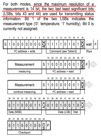

According to the SHT20 datasheet, it uses standard 8-bit data size:
why do you think so? According to the data sheet, the sensor has a 7-bit I2C target address and normal, byte wise data transfer.

@Damdori​ "MX only supports 10bit...."
Are you confusing data size with the addressing modes there?
Ah, I guess I misunderstood.

Some older sensirion are not 100% I2C and provide special bit bang sw I2C dur to some long clock stretch delays, probably due to slow mcu built in the sensor to convert analog to digital I2C.... check this first.
Pavel A.
Unless your SHT20 is old, it supports two sets of commands. One uses SCL stretching, another does not. In the second case the device does not respond while busy. So just use the non-stretching commands and the usual HAL functions: HAL_I2C_Master_Transmit, HAL_I2C_Master_Receive etc.
Poll the device every N ms until it responds or you wait more than documented maximum (~ 100 ms, see in the data sheet)
 The I2C address is 0x80.
