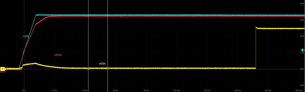

It didn't work on this try (DAC voltage in yellow):

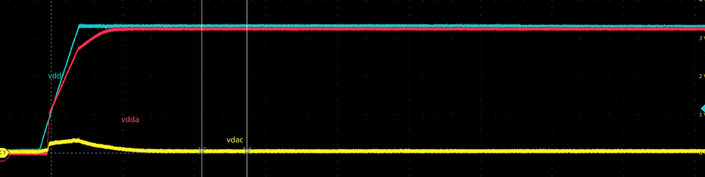

0693W00000QKcDbQAL.pngIt did work on this try (see DAC voltage rise in yellow):

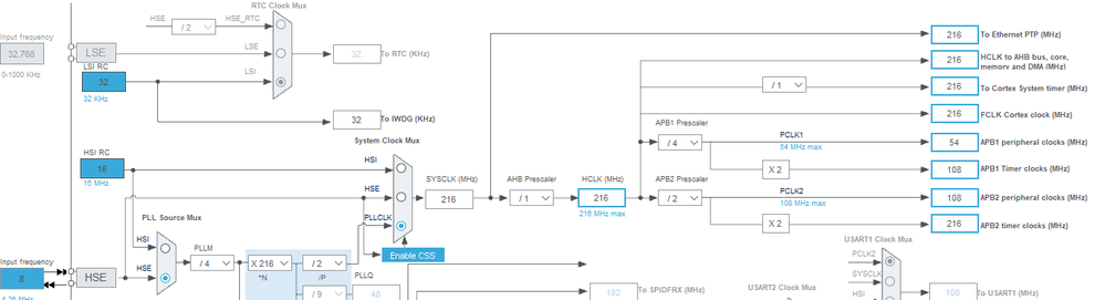

It almost seems like sometimes the clock for that peripheral doesn't enable sometimes - just my guess at this point. Here's the clock configuration in CubeMX (v5.3.0):

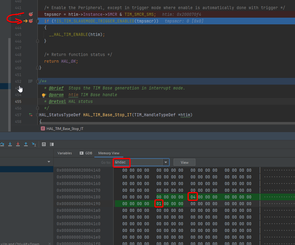

No, it wasn't, so the question is why:
DAC wouldn't enable because DACEN bit in RCC APB1 Enable Register wasn't set
RCC DACEN bit isn't set because DAC is in the ERROR state at that section
DAC goes from the RESET state to the ERROR state upon running the content of the content between the breakpoints shown in the HAL_InitTick function for TIM6 (TIM6 is used as the timebase source).
I can see the contents of the hdac register change as we execute the code between the two breakpoints. Interesting to note that there is no changes to hdac in memory if the code is stepped over, only happens when I run the code from one break point to the other.
The changes are DAC_ERROR being set in hdac->State, and the HAL_DAC_ERROR_DMAUNDERRUNCH1 errorcode being set in hdac->ErrorCode. Weird since I'm not even using DMA with the DAC.

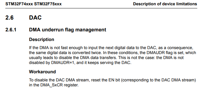

I noticed something about this is present in the STM32F765 errata - maybe it's related to this known issue with the DAC DMA underrun flag?

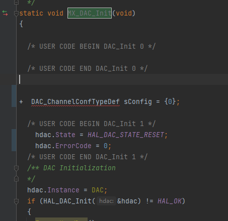

0693W00000QKmhbQAD.pngThis fixes it in the MX_DAC_INIT function, unsure if there's any caveats in doing this.
0693W00000QKmjmQAD.pngThanks for the help!

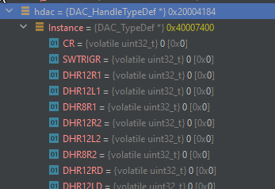

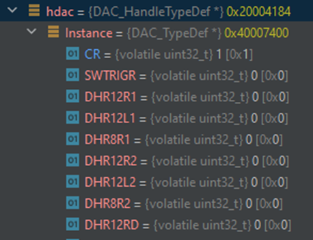

Good call. It seems like __HAL_DAC_ENABLE is not setting the enable bit in the DAC control register?
After __HAL_DAC_ENABLE when it doesn’t work:
0693W00000QKioEQAT.pngAfter __HAL_DAC_ENABLE when it works:
0693W00000QKioJQAT.pngThis seems pretty strange - what would prevent memory from being changed in one register set line?

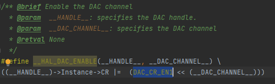

__HAL_DAC_ENABLE is only setting the DAC_CR_EN1 bit:

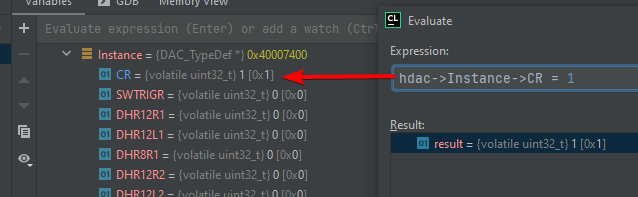

I think the most convincing way to show the problem is trying to directly edit the register by evaluating the assignment expression with the debugger:
0693W00000QKir3QAD.pngThis only results in CR = 1 when it's "working", otherwise CR = 0 after evaluating that

This is something intimately Cube/HAL rrelated. I doubt the erratum is involved.

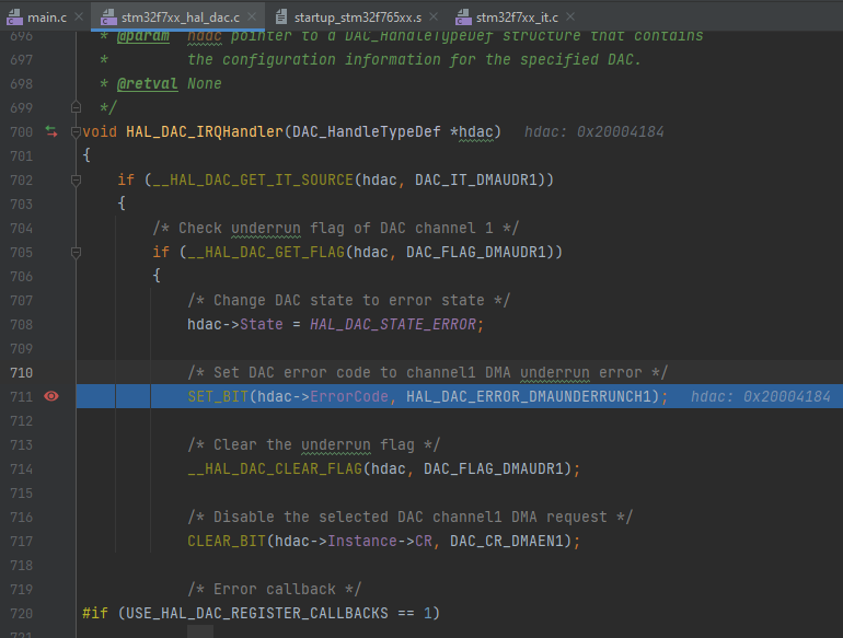

Then th​is happens in interrupt.

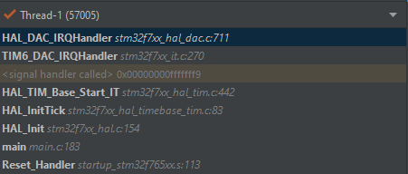

Place a data breakpoint (a.k.a. watchpoint​) on some of these variables to see, where are they changed.
Auhv
hdac is indeed modified during an interrupt as you suggested - TIM6_DAC_IRQHandler , which seems to handle DAC DMA underrun errors. I suppose the question is why the DAC sets the DMA underrun flag in the first place.
waclawek.jan
You've said that DAC at this point does not have enabled clock in RCC, and in that case reading it may return unexpected values. In other words, you are not supposed to read DAC until you enable its clock.
What probably happens here is, that you enable the TIM6 interrupt and it fires for whatever reason (probably this reason), but as DAC and TIM6 share interrupt, Cube/HAL calls also the DAC handler portion which reads the yet-not-enabled DAC registers and makes false conclusions.
