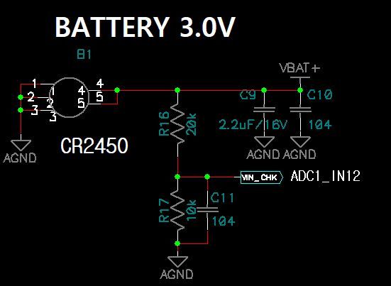

I am STM32L422 to measure ADC using internal reference voltage.
My code is generated using CubeMX V6.2.
I want to measure ADC from ADC1_IN1 using PA7.
The data sheet says internal voltage is 1.2 V. Reading VREFINT register gave value 1658 which is 1.214 V from 3v full scale.
My maximum voltage input is 3V. It is connected to ADC in through 20k/10k voltage divider.
3V *10/30 = 1V
But I get 0.595 V.
If Vref = 1.2, then I should get 1.2 V in Vref pin but Vref pin voltage is 0.535 volt.

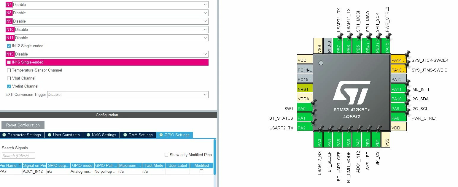

To enable internal reference voltage, I have checked Vrefint Channel in ADC

0693W00000GXr1aQAD.jpg0693W00000GXr20QAD.jpgMy initialization code is generated using CubeMX V6.2.
What is the problem here ?
What "Vref pin"?
There is no separate VREF+ pin on 'L422KBTx, it's connected to VDDA which you are supposed to connect to analog supply voltage. (The only 'L422 with separate VREF+ pin is in WLCSP36 package).
Also, in 'L42x, there is no VREFBUF module i.e. you can't output the internal reference voltage.
