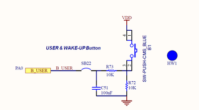

doesn't work GPIO_EXTI in original project
curiae
I made a GPIO_EXTI test project referring to GPIO_EXTI sample.
For just check, I added entering Stop Mode int the GPIO_EXTI sample and HAL_GPIO_EXTI_Callback worked regularly like following.
HAL_PWR_EnterSTOPMode(PWR_LOWPOWERREGULATOR_ON, PWR_STOPENTRY_WFI);
while (1)
if(stop_flag == 1)
stop_flag = 0;
// Enter Stop Mode
void HAL_GPIO_EXTI_Callback(uint16_t GPIO_Pin)
if(GPIO_Pin == KEY_BUTTON_PIN)
// Toggle LED3
BSP_LED_Toggle(LED3);
stop_flag = 1;
But in my project the HAL_GPIO_EXTI_Callback didn't occur.
So I checked difference for both initial settings in SystemClock_Config() and GPIO_Init() but I could only find difference __HAL_RCC_PWR_CLK_ENABLE() and __HAL_PWR_VOLTAGESCALING_CONFIG(PWR_REGULATOR_VOLTAGE_SCALE1).
How should I resolve it?
Just for reference I'll write both settings.

Sorry for insufficient information and I didn't know how to use this post since it's my first post.
I'm trying on STM32L0538-Discovery.
I made a project referring GPIO_EXTI sample that works normally after Stop mode with RTC.
But EXTI interrupt didn't work  in my project.
That's the my situation.

As per the board schematics, User button is active High, so I suggest to replace:
GPIO_InitStructure.Mode = GPIO_MODE_IT_FALLING;
by
GPIO_InitStructure.Mode = GPIO_MODE_IT_RISING;

I  don't use any low power mode except using HSI and  GPIO_EXTI sample works with HSI.
As result after inserting __HAL_RCC_PWR_CLK_ENABLE() into SystemClock_Config(void) that isn't written generated SystemClock_Config(void),  EXTI interrupt itself occurred.
Lacking it is the cause?
