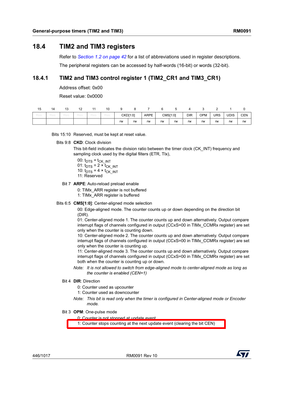

htim5.Instance->CR1 |= (1 << 3);
HAL_TIM_PWM_Start(&htim5, TIM_CHANNEL_1);
I wrote the code like this, but it doesn't work. -> The signal will remain at the High level only.
Do you happen to have an example code?

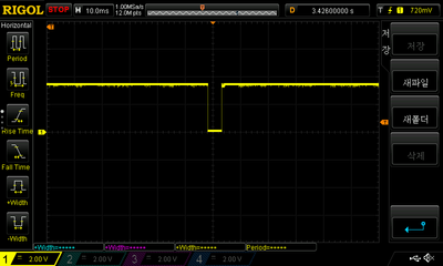

I'm changing pwm mode and opm mode using external buttons.
When entering opm mode, keep high level and generate pulse. I want to keep low level and generate pulse.

waclawek.jan
Then you have either use the other PWM mode, or invert the output signal using TIMx_CCER.CCxP.
You may need to change also TIMx_ARR and TIMx_CCRx between the PWM and one-pulse mode to fit your expected output waveform.
