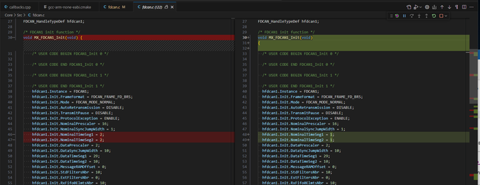

So tha problem is that during the cubemx update the NominalTimeSeg parameters were changed.

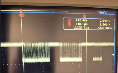

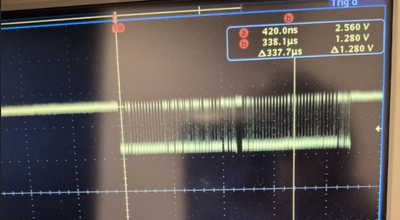

My device functions as both a receiver and a sender and is connected to the Vector CAN tool (VN1630A) and CANoe software, which I use to monitor and send data to my device.
Of course, I’ve checked what’s happening on the line. The transaction looks incorrect, which is causing the stuffing error I’m observing. This issue only occurs after migrating the project from STM32CubeMX 6.12.1 and FW_H7 1.11.2 to STM32CubeMX 6.13.0 and FW_H7 1.12.1.
Here you can see how it looks before the update:
And here it is after the update:

I don’t think the post you mentioned has anything in common with my issue. The Nominal Time Seg1 and Nominal Time Seg2 were correct and set to 2. However, after I updated the CubeMX version from 6.12.1 to 6.13.0, these parameters were magically changed to 1 :)
Hello @tuo ,
On STM32CubeMX 6.12.1 the initial value of Nominal Time Seg1 and Nominal Time Seg2 are equal to 2.
This issue is fixed on STM32CubeMX 6.13.0 under this internal ticket: 185818.
Therefore, after the migration you find that the Nominal Time Seg1 and the Nominal Time Seg2 are equal by default to 1.
Thanks.
Mahmoud
The problem is that 2 - is the value that I set and I needed it to remain 2, not 1.
