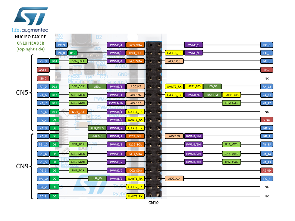

I've been struggling for a while now to start the SPI1 protocol on the Nucleo-401RE. According to the datasheet, SPI1 is connected as follows,
I generated the code in CubeMX and without adding a single line of code, compiled it without any failures and uploaded it on the board.
What i expected is at-least the SCK pin to generate some clock pulse when connected to a Logic analyzer or an oscilloscope. Instead i get no response. As in a straight line on both indicating 0 volts.

What exactly am i missing? I checked several times that my pin connections coincide with what the datasheet says. But i still can't see anything either on the oscilloscope or logic analyzer.

Try setting the given pins as GPIO, toggle them and observe.
Read out content of relevant GPIO and SPI registers and check/post.

I did check out the toggling functionality on the individual GPIO pins and it worked well. Still cant seem to activate SPI. looked around on some similar implementations and they do have the same configuration as i do. I tried out with a Nucleo-F303k8 and still the same negative effect. This thing is driving me nuts for sure

have a look at the schematic at https://github.com/Nastrawww/STM32F401RE/blob/main/NUCLEO-F401RE_Schematic.pdf
Look at sheet 4 there are some solderbridges (SB44) Take a look at the manual to see what the
bridges do. I has had an ssue with the L412 there are solderbridges they are closed by default and shorted
I²C and SPI.
hth
