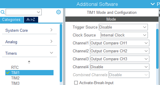

i am using the STM32F103C6 MCU and i would like to produce 3 different Center Aligned PWM signals with 16KHz frequency and Duty Cycle 1 to 99%. I would like to change the duty cycle on fly using the CCR registers.
I am configuring the 3 of TIM1's channels as Output Compare:

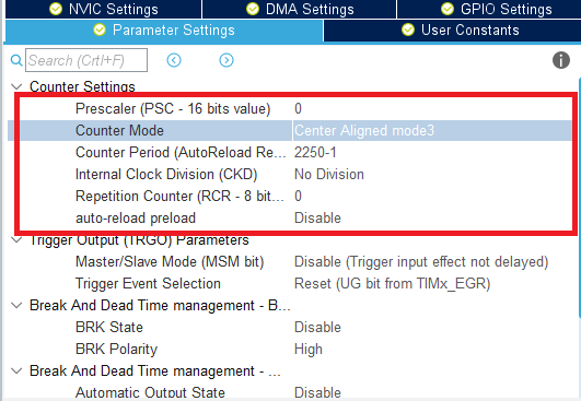

Then i choose the Center Aligned_3 mode and setting the frequency on 16KHz (frequency is correct):

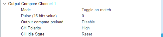

Finally, every channel has the same settings as below:
With CubeMX's default code, i am just starting the OC and setting the desired pulse:

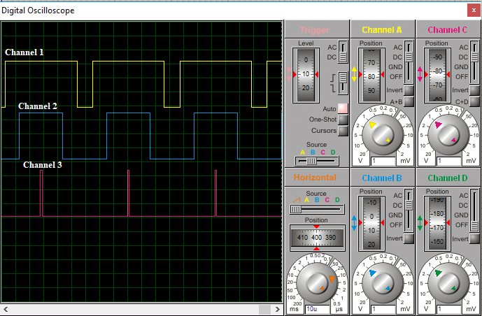

TIM1->CCR1 = 400; //Channel_1 ~ 82% Duty Cycle
TIM1->CCR2 = 1125; //Channel_2 ~ 50% Duty Cycle
TIM1->CCR3 = 2200; //Channel_3 ~ 2% Duty Cycle
And on simulator everything is correct:

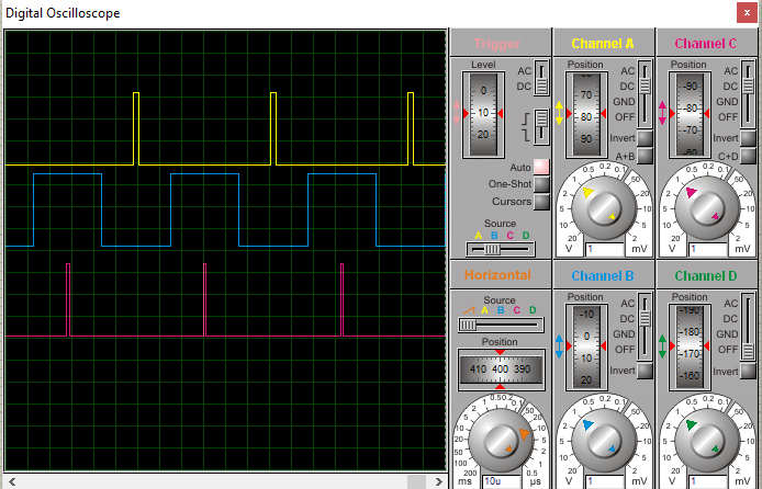

If we change the CCR1 to lower value:
TIM1->CCR1 = 100; //Channel_1 95% Duty Cycle
Seems like Channel 1 is not aligned with the others, like it is shifted:
- Can someone help me and explain me what i am doing wrong?
- Is there any other way to produce those Center Aligned PWM signals?
- What is the safest way to change duty cycle on fly? Should i use the compare IRQ?

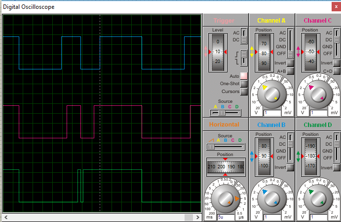

Now i am using the "PWM Generation CHx" option but i am still facing issues with the alignment.
With the below settings:

The output looks like this:
‎2020-04-18 5:06 AM
I have done similar projects with 8bit MCU from other manufacturer, as i remember there were some limitations on duty cycle on center aligned PWM (could not go to 0% or 100% - you had to select).
So there is the same issue here, a cube bug or what? Could someone help?

‎2020-04-18 1:45 PM
Due to quarantine, i have not access to oscilloscope. That's why i am using simulator.
I don't think the problem is Proteus-Simulator.
