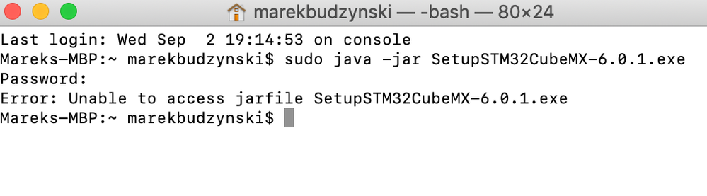

0693W000003PPG6QAO.pngDownloaded and installed the latest Java development kit. Tried installing SetupSTM32CubeMX-6.0.1 via: sudo java -jar SetupSTM32CubeMX-6.0.1.exe but get this error message: Error: Unable to access jarfile SetupSTM32CubeMX-6.0.1.exe .
Any ideas?

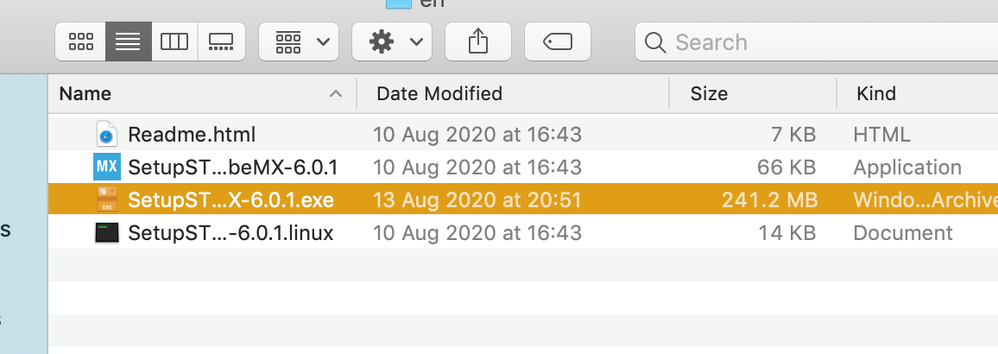

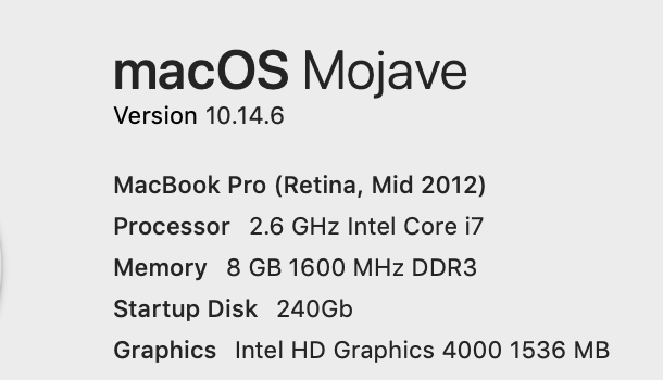

0693W000003QYuvQAG.pngHello,
Thanks for replying. I'm running Mac OS 10.14.6 and downloaded the latest Java:

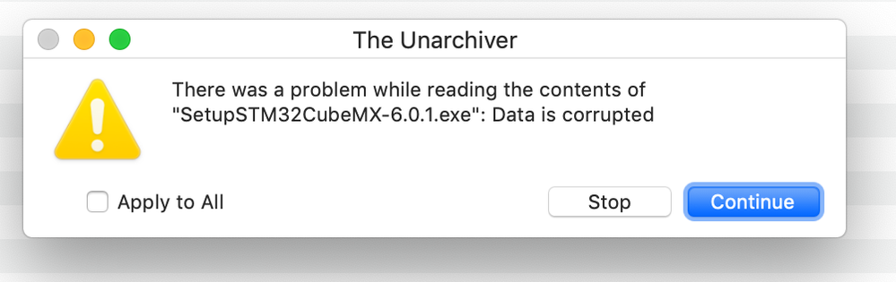

Bit doesn't recognise the .exe file and says the the data is corrupted:0693W000003QYz7QAG.png
and nothing happens when I double click the app.

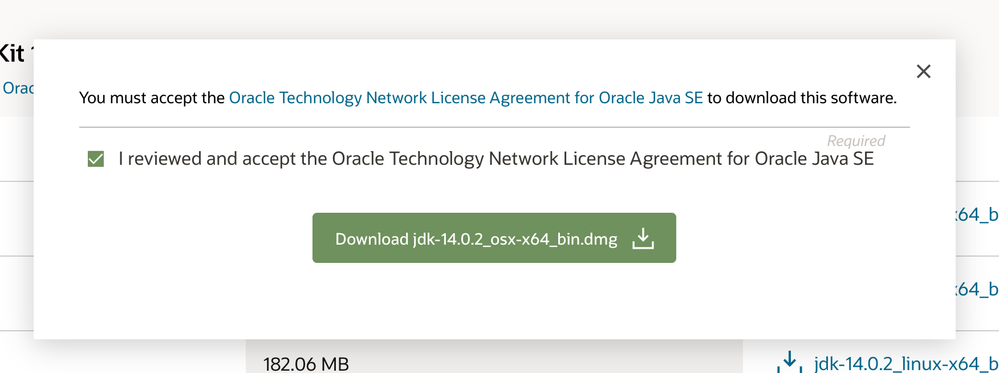

Can you try installing Oracle JDK and not JRE ?
Because STM32CubeMX works fine only with JDK and not JRE in macOS environment.

MBudz.1
That's interesting I downloaded and installed this:0693W000003QbPIQA0.png
Once again I double click on the app:
and nothing happens
This is my operating system etc.
Do you have any other solutions as I can't get it to work in any way?

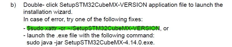

Can you apply this command [to bypass Gatekeeper]:
Extract from STM32CubeMX User Manual:

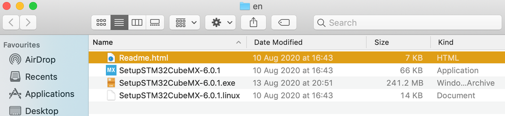

Just one clarification, you need to double click the .app file and not .exe file to start STM32CubeMX
The .exe file is only used with command line 'java -jar'
Regards,
Aymen.

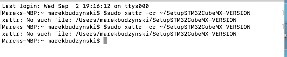

MBudz.1
I did double click the ,app files and it won't open when I double click it.
I tried using this and it gave me an error message:
Then I tried this:
Still can't open it.
Any other ideas?
Aymen CHAKROUN
Hi @MBudz.1​ ,
My Screenshots was for any MX VERSION, you need to change the VERSION by the correct one.
So in your case:
sudo xattr -cr ~/SetupSTM32CubeMX-6.0.1

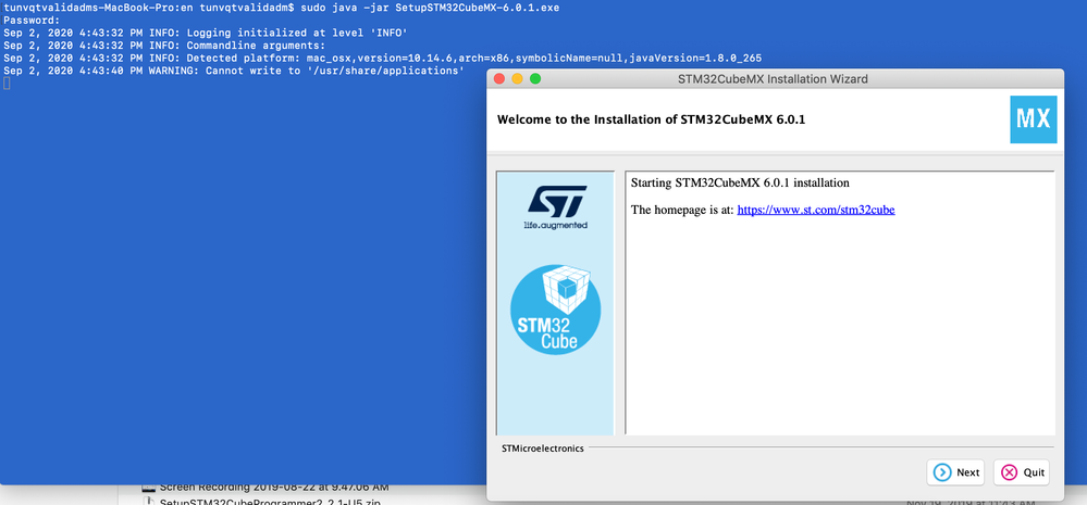

Also, try doing the java -jar without sudo:
java -jar SetupSTM32CubeMX-6.0.0.exe
Regards,
Aymen.
MBudz.1
Got it to work. Thanks for all of your help.
