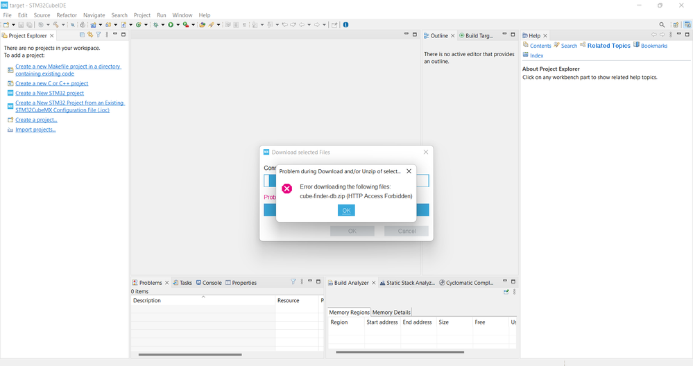

Problem during download - access forbidden.
Not able to download cube finder db.

Hello @Roberto Peruzziniradheep​ ,
Make sure to use CubeMX with admin right.
Please have a look at this post, it may help you.
Don't hesitate to come back here with update.

This is a very strange advice. The finder db is under the user profile directory. CubeMX should never require admin rights (or elevation).
If the machine is under a company management (internet filtering, some "security" software installed...) - ask your IT.
