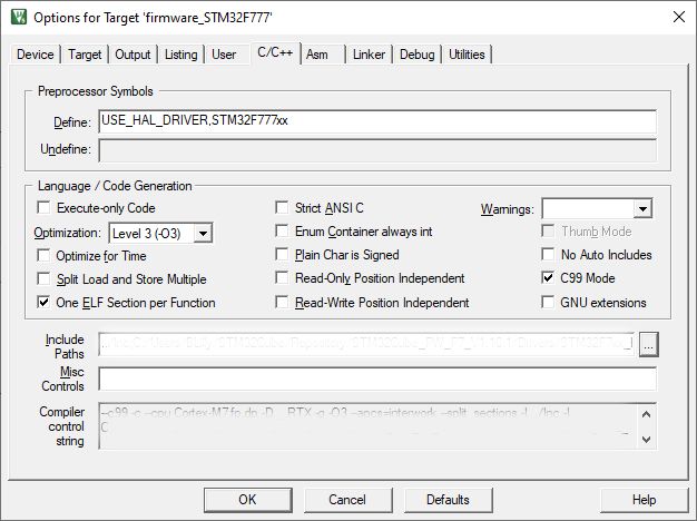

Pre_Include_Global.h(27): warning: #47-D: incompatible redefinition of macro "USE_HAL_DRIVER"
BLill.2
What's with this warning, and how do I avoid it (apart from commenting it out). Is there something that I'm doing in error in STM32CubeMX?
I'm using Keil uVision V5.33.0.0 with an STM32F7 processor.
Andrew Neil
It's exactly what it says: At that point, you already had a definition of "USE_HAL_DRIVER" - and you've re-defined it as something different.
The build output should also tell you where the previous definition was.
So look at the two definitions, and decide which one is the one you want.

I guess that makes sense, but the problem is that apparently STM32CubeMX dumps it into the project options when the code gets generated. The only other place it occurs is in Pre_Include_Global.h.
I'll just rip it out of the project options and go from there.

I have the same problem with Keil uVision V5.36.0.0, STM32H7 processor (with package DFP v 2.8.0) and STM32CubeMX 6.3.0.
I don't see the warning if I downgrade DFP back to version 2.7.0.

here I attach my .ioc file.
One important thing is that with Keil::STM32H7_DFP v 2.8.0 I see the warning.
With Keil::STM32H7_DFP v 2.7.0 everything is ok.
With no changes to Keil uVision and STM32CubeMX.
