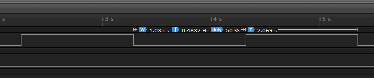

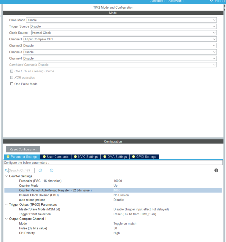

I am trying to generate pulses using output compare mode for my stepper motor on my board STM32f103C8T6 and STM32F401CCU6 on various timers. For some reason I am not able to change the period i want the signal to toggle at i.e
sConfigOC.Pulse
Here is my config:0690X00000AtGddQAF.png
Here is my output, it remains the same regardless of changing the pulse:

  sConfigOC.OCMode = TIM_OCMODE_TOGGLE;
  sConfigOC.Pulse = 500;
No, use one of the PWM modes.
my previous practice was to use the PWM mode;
by changing the ARR value and CCR = ARR(value)/2 to allow me to change the frequency. But this means that it will also affect the other channels under the same timer. Which is not very critical but trying to find a better solution for this in-case in future i have to use more channels under same timer.
