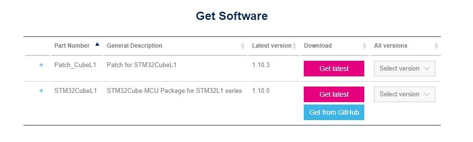

0693W00000JMvn0QAD.jpgI downloaded 2 files from "https://www.st.com/en/embedded-software/stm32cubel1.html".
(1) en.patch_cubel1_v1-10-3_v1.10.3.zip
(2) en.stm32cubel1_v1-10-0_v1.10.0.zip
I unzipped each of them to the locations below.
C:\Users\Tom\STM32Cube\Repository\en.patch_cubel1_v1-10-3_v1.10.3
C:\Users\Tom\STM32Cube\Repository\en.stm32cubel1_v1-10-0_v1.10.0
[Q2]
Do I need both folders?
Otherwise, after copying the files from the "en.patch_cubel1_v1-10-3_v1.10.3" folder to the "en.stm32cubel1_v1-10-0_v1.10.0" folder,
Delete the "en.patch_cubel1_v1-10-3_v1.10.3" folder,
Can I just leave the "en.stm32cubel1_v1-10-0_v1.10.0" folder?

KnarfB
January 22, 2022
in the Repository folder, firmware packages and versions will accumulate over time. This is needed if you have real-world projects that you don't want to or cannot migrate to a newer firmware version.
Treat this folder like read-only at the file level and use it as a valuable source for examples... as you already did.
Manage the contents via STM32CubeIDE or STM32CubeMX Help > Manage Embedded Software Packages. Then the software knows, what is installed.
hth
