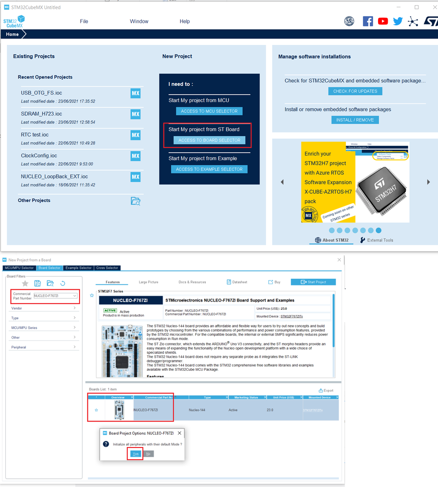

I think the simple way to generate USB_FS by using CubeMx with NUCLEO STM32F767ZI is to start your project from "Home" and select "Access to board selector" instead of MCU. Then let CubeMx initialize the board. You can add your code after ..
