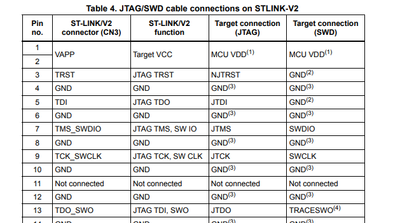

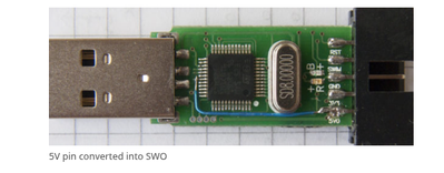

Didn't know the STLINK V2 does SWO. I used the V2 ISOL for a long time; works ok.
see manual:
on cheap V2 "clones" you have to solder it yourself, to get swv :
