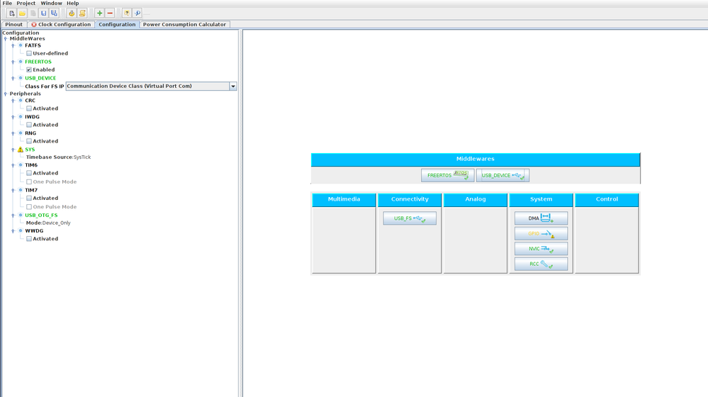

Steps to reproduce:
Create project in CubeMX for STM32F4DISCOVERY, enable USB_FS Device only. Configure clock: PLL_N = 72, PLL_Q=3, that gives me 48 MHz for usb, other settings remain unchanged. In configuration I enable CDC device with default parameters. Generate code for SW.
I add some led toggle in order to know it it is running.

Posted on January 13, 2017 at 18:56
Nope, I'm not adding anything but one line for blinking led. Beside that pre code generated by CubeMX
https://hastebin.com/ucobocuwih.swift
and here settings from CubeMX:
I will try now to makek it without freertos to see if something will change.

Posted on January 13, 2017 at 21:53
By default CubeMX sets rx and tx buffer to 4 bytes (but they remain in user code section.
/* Define size for the receive and transmit buffer over CDC */
/* It's up to user to redefine and/or remove those define */
#define APP_RX_DATA_SIZE 4
#define APP_TX_DATA_SIZE 4�?�?�?�?
further buffers are defined one by one, so while receiving data if you go outside rx buffer, you will be in tx buffer (so kind of safe zone), writing 9 bits will write data further.
