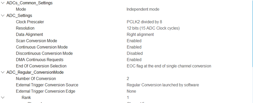

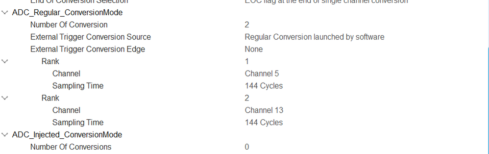

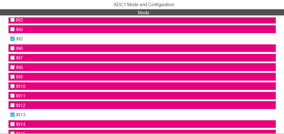

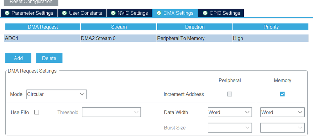

Hello, I am working with the STM32F429-DISC1 development board. I am trying to read two adc from one channel. I can't read the code that I could read in the past. The code that worked in the morning is not working now. I may have changed a little. Please help me. My code is at below:

The buffer is being read when the ADC completes conversion of the first channel.
Read when when the DMA count goes to zero.
2022-10-02 8:11 AM
Can you please explain more detailed?
2022-10-02 1:43 PM
Differences I have seen with the F429DISC1 HAL Library ADC DMA example:
Scan Conversion Mode is Disabled
End of Conversion Selection is Disabled.
Did you modify one or both of those?

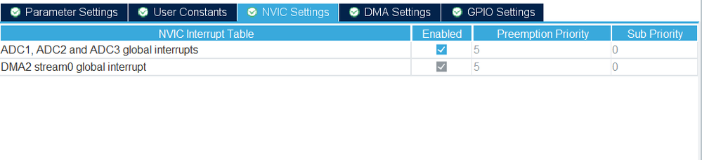

Insert a breakpoint in the void HAL_ADC_ConvCpltCallback(ADC_HandleTypeDef* hadc)
function to see if this gets executed. If it doesn't, an ADC1_DMA_IRQHandler interrupt handler may be missing.
2022-10-05 2:51 PM
