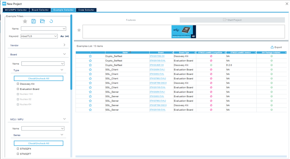

Unfortunately, MQTT cannot be configured through STM32CubeMX interface. However, preconfigured projects based on mbedTLS are available through STM32CubeMX > Example selector. They may be handy to correctly configure and work with MbedTLS:
0693W00000CzhuRQAR.pngAlso, exploring the STM32CubeF7 Firmware , in <Firmware_location>\Middlewares\Third_Party\LwIP\doc directory you'll find mqtt_client.txt file detailing steps to use MQTT client for lwIP. It may be helpful in your case.

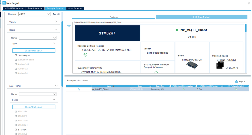

It accessible through Example Selector of STM32CubeMX:
0693W00000CziIiQAJ.pngIt may be a good orientation for you to develop your project.
