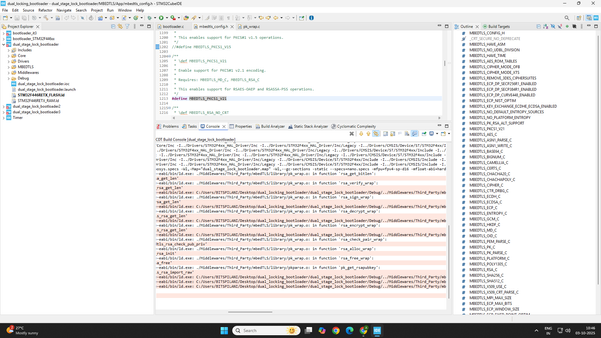

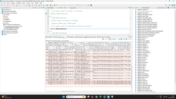

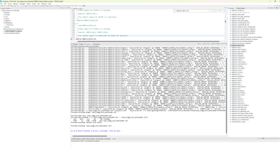

I want to use the rsa feature of mbedtls but when I uncomment #define MBEDTLS_RSA_C in the mbedtls_config file it is showing undefined reference to mbedtls_rsa_get_len, mbedtls_rsa_check_pub_priv, mbedtls_rsa_init, mbedtls_rsa_free and mbedtls_rsa_import_raw.

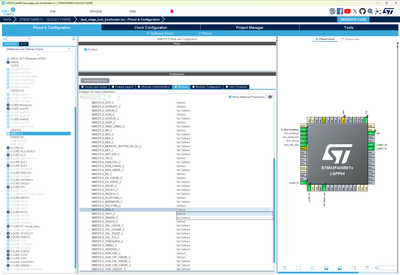

In STM32CubeMX, follow these steps to enable RSA support in MbedTLS:
1- Under Middleware, select MbedTLS.
2- Go to the Module tab.
3- Enable the option Show Advanced Parameters.
4- In the search bar, type MBEDTLS_RSA_C.
5- When you find the MBEDTLS_RSA_C option, set it to "Defined" ( select "Defined" from the dropdown).

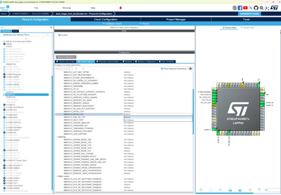

Then Go to Feature support tab and change the value of MBEDTLS_PKCS1_V15 and MBEDTLS_PKCS1_V21 to defined
Generate and build the code : the rsa.c will be added successfully to your project

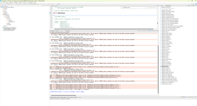

After uncommenting the line #define MBEDTLS_RSA_C, I encountered the following build error:
In file included from ../MBEDTLS/App/mbedtls_config.h:3294,
                 from ../Middlewares/Third_Party/mbedTLS/library/camellia.c:31:
../Middlewares/Third_Party/mbedTLS/include/mbedtls/check_config.h:511:2: error: #error "MBEDTLS_RSA_C defined, but none of the PKCS1 versions enabled"
  511 | #error "MBEDTLS_RSA_C defined, but none of the PKCS1 versions enabled"
To resolve this issue, I also uncommented #define MBEDTLS_PKCS1_V21 in the configuration file.
After making this change, the build completed successfully  I did not encounter any undefined reference errors.

Hello @Ghofrane GSOURI
I uncommented #define MBEDTLS_PKCS1_V21 but its giving this build error.
Advait
I am not able to enable features using the GUI
Hello @Advait
Are you using the latest version of STM32CubeIDE 1.19.0?
No, I am currently on 1.17.0
Hello @Advait
Please use the latest version of STM32CubeIDE (1.19.0). I have already tested it, and the build completed successfully. There may be issues present in version 1.17.0 that have been resolved in 1.19.0.
