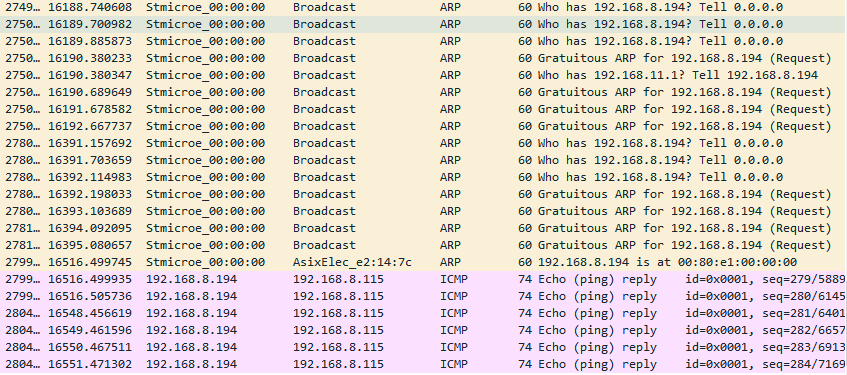

I seem to be having some problems with the code generated via STM32CubeMX on the NUCLEO-H743ZI development board. I want to configure it to run on LwIP/RAW API. I can create such a configuration for its close relative: the NUCLEO F767ZI development board. In the latter case I take the following steps:
- Set the HCLK to 216 MHz (clocked from the HSI);
- Enable the ETH peripheral, set it to RMII mode, and set ETH_TXD0 and ETH_TX_EN pins to PG13 and PG11 (others are mapped appropriately);
- Set the PHY address to 0 in ETH Configuration>General: Ethernet Configuration
- Enable the LwIP middleware;
- Enable ICMP (LWIP_BROADCAST_PING and LWIP_MULTICAST_PING in LwIP Key Options>IPMP Options). This step is not necessary, although it helps to determine if all is well with the device.
After I generate the code, I add an extern variable to my main.c to be able to track whether the device has obtained an IP address:

This code works well and I am able to get an IP address (I can determine it frome the gnetif->ip_addr field), I can see all the proper ARP request in WireShark and I am able to ping the device:
Herein, I am filtering only the traffic from/to the appropriate (STM32) MAC address 00:80:E1:00:00:00.

If I upload this (nearly identical) build to the NUCLEAO-H743ZI board, I get no network activity (No ARP requests to get an IP address.
Now I know that the issue is somewhere in the STM32CubeMX generated configuration. The hardware itself is good. There is an example of a LwIP HTTP server in STM32Cube_FW_H7_V1.1.0 which works just fine if I upload it to the board. The LwIP_HTTP_Server_Netconn_RTOS example in STM32Cube_FW_H7_V1.1.0 is somewhat different: it uses a RTOS and the Netconn API. For my application I want to stick with Raw API (and no RTOS). So my question would be, what am I missing in my microcontroller configuration?
