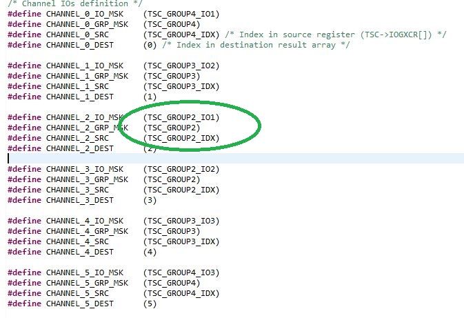

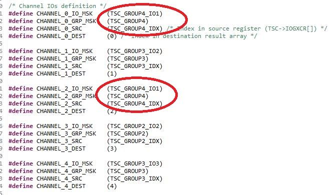

Hi, when I generate code for the SMT32L412RBTxP using TSC with CubeMX I get duplicated entries in tsl_user.h.
One channel does not work. So I edit Channel 2 to use the missing group and IO:
It now works, but when code is regenerated with CubeMX it overwrites this back to the first image.
Is this a bug or am I doing something wrong?
Thanks, Lance.
Solved! Go to Solution.

Hello @Lanceh
First let me thank you for reporting.
Actually , this is a known issue that has been reported to dev team in this ticket 154423 and will be fixed as you as possible.
I will keep you posted with updates.
THX
Ghofrane
