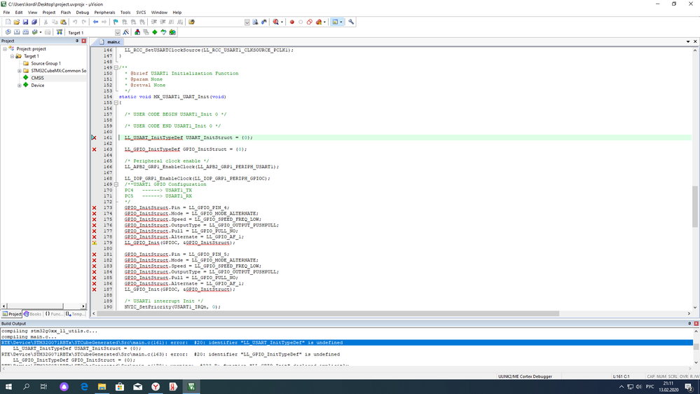

I got to the point where keil opens a project using this manual https://www.keil.com/pack/doc/STM32Cube/General/html/cubemx_proj.html
and imports settings from CubeMx but writes the following errors:
STM32G071RBT6 - Nucleo board (noBSP)
LL tried
HAL tried
Keil version 5.29.0.0
CubeMX 5.5.0
java 13 64 bit
Windows 10 64 bit
Do I need to add something else?
Can your suggest anything?
Thanks.

Hello @DKorz.1
Could you please share your ioc file to check the issue.
Best regards,
Nesrine
