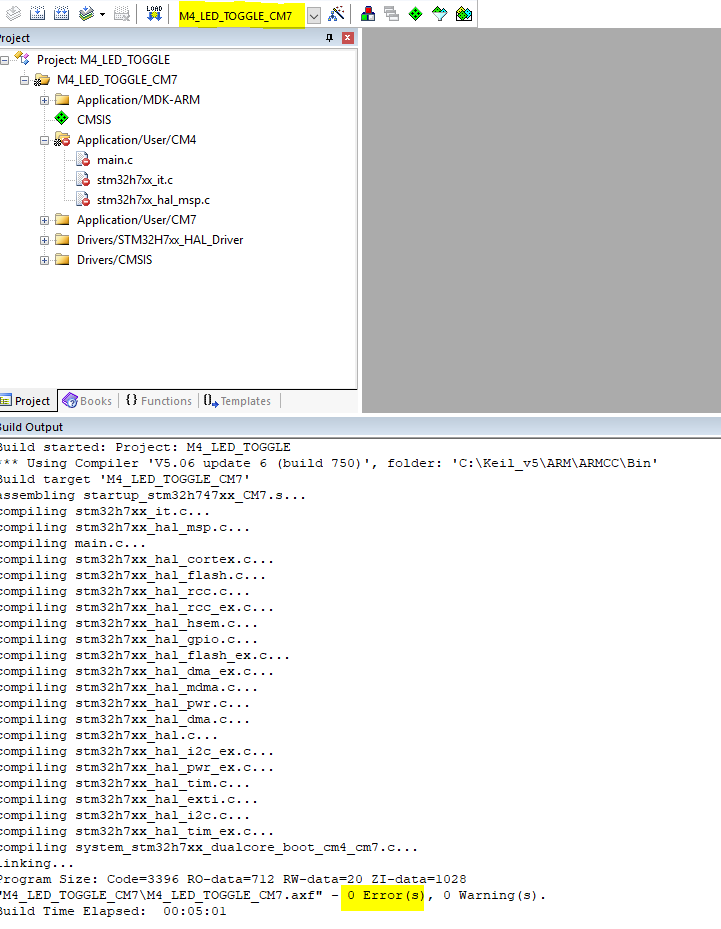

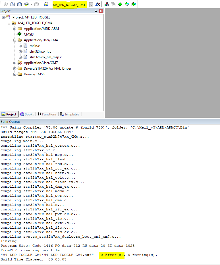

But why is the generated Keil project doesn't build? Is the generated default code should be building without any issues right? Can you please look at this Keil project generation for the same ioc file? This is because we are using both IAR and Keil for now to decide one of these two toolchains.
​For keil -M4 , no error reproduced
Khouloud ZEMMELI
​Same result for keil-M7
