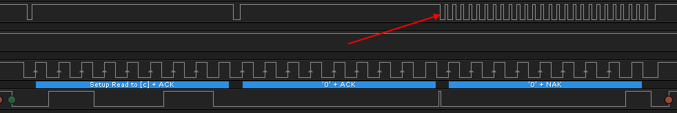

I'm noticing lots of interrupts during reception of the last byte. Should there not just be one interrupt at the end of the last byte received?
The top trace in the following screenshot shows entry/exit to/from the I2C Event ISR.

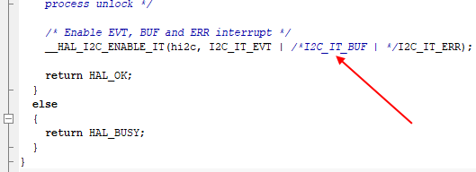

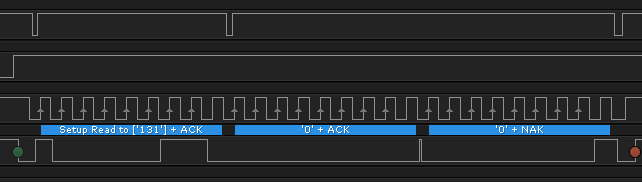

It seems the fix is trivial. Just don't enable the ITBUFEN interrupt in HAL_I2C_Master_Transmit_IT and HAL_I2C_Master_Receive_IT:
The resulting bus capture looks perfect:
It would be great if an ST engineer could comment on this and whether this is a sound solution.
‎2020-05-14 7:47 AM
...on reflection, this can't be a proper solution. There is no interrupt when the first byte of two has been received.
