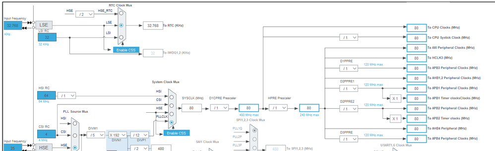

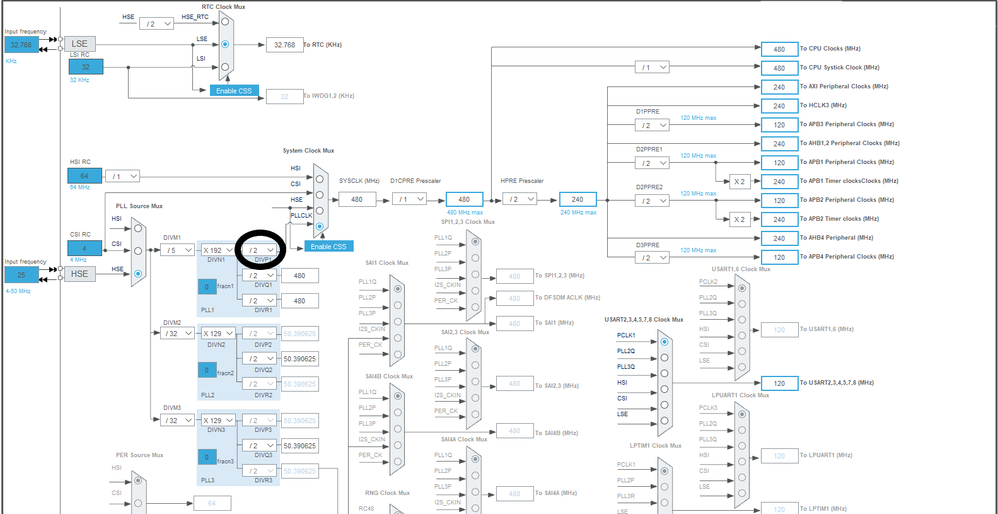

Here's my clock configuration

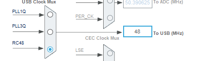

I could reduce the clock from 480MHz to 120 MHz by changing RCC_OscInitStruct.PLL.PLLP from 2 to 8 .
But when I try to change clock to 96MHz or 80 MHz by changig RCC_OscInitStruct.PLL.PLLP to 10 or 12, the USB is not recognized by windows!!!

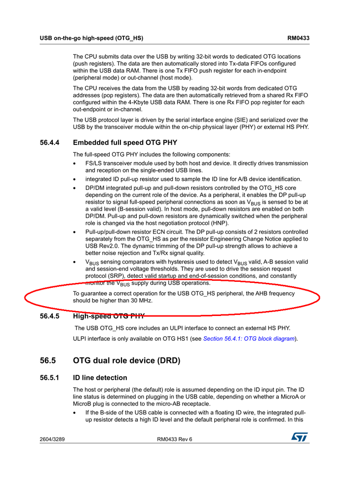

OK so try with decreasing the clock change the AHB prescaler so that AHB frequency stays at or above 60MHz.
Did that change anything?

waclawek.jan
When I change RCC_OscInitStruct.PLL.PLLP fro 2 to 8 the AHB Clock is reduced from 240MHz to 60MHz,
when I set RCC_OscInitStruct.PLL.PLLP to 10 the AHB clock is 48MHz
when I set RCC_OscInitStruct.PLL.PLLP to 12 the AHB clock is 40MHz
So the AHB Freuquanc is still greater than 30MHz
waclawek.jan
0693W000001cFUuQAM.pngyes, it's working
reducing main CPU clock while keeping AHB clock high solves the problem

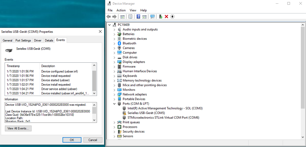

Sometimes the USB device is mapped to different VCOMPort even that I am using the same serial number string descriptor
and sometimes The device is not recognized by Windows as shown in the attached pics0693W000001cIISQA2.png0693W000001cIINQA2.png
