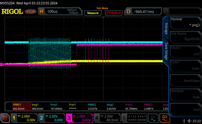

Anyway, I have been able to start the transmission to the slave and I am able to get the response through the hardware and I can see that on the oscilloscope as shown in the image below:

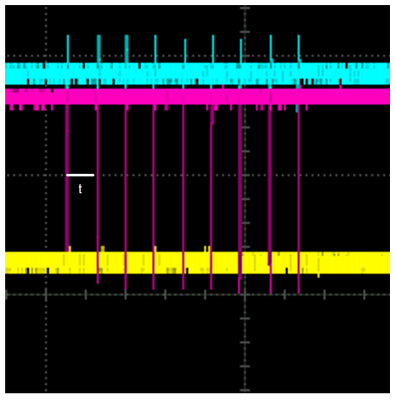

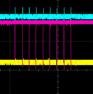

The blue signal is the power line that shows transmission pulses and the small noise like reception pulses. This response is fed into the hardware that also includes the comparator and the pink/purple signal is the response on PA0, that is the forwarded output of COMP1 to the external pin.
The comparator interrupts are enabled after the transmission is done, before the slave starts to respond. I expect to get 8 bits of data as this is the reset command, and I am getting that on the scope.

Long story short, any step by step help to start the timer once the first pulse is received, store the value in a variable, reset the time count and start again, the values of the time could be stored in an array or converted into binary in real time - (which should not be a problem I hope, fingers crossed).

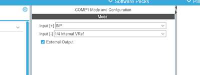

The signal back from the slave is a very small transition of 100mV, I do not know a way of digitally isolating a high from low with 100mV of difference, so to 'amplify' it was fed into the comparator to get a strong/nice(r) signal.

So basically at so small signal your idea to use comparator is good.
You could also set comparator to both inputs external and connect (-IN) to DAC output, to adjust the switching level very fine.

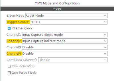

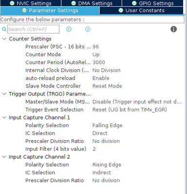

Yes, not super easy...i show you : i use tim5 here, but up to you, to use another :
I have 96MHz clock, so you have to adjust prescaler : (tim core clk) / (xx-1) -> 0,1us (at 48MHz : psc 4 -> about 0,1us);
counter period : set what maximum time could be, more is not possible, so counter limits by itself to this time.
input filter: to suppress short spikes .
