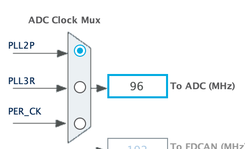

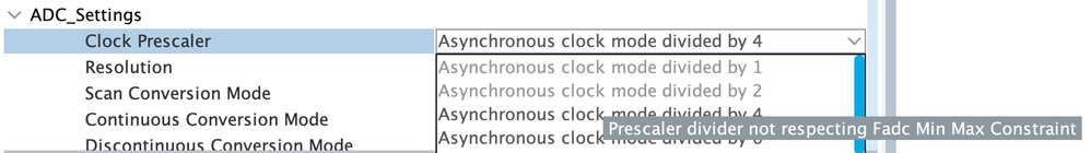

I tried using STM32CubeMX to configure an STM32H725 LQFP-100 device to get fADC=48MHz by getting the ADC Clock Mux output to 96 MHz, and using a /2 prescaler on the ADC1 peripheral but the drop-down for "ADC Clock Prescaler" only allows /4 or higher (24MHz or lower).
I need fADC=48MHz in order to sustain a high sampling rate. What am I missing?

What do the datasheet and RM say about the maximum ADC clock?
Do you select properly the ADC clock source? Don't you try APB as source?

I assume that it is a limitation regarding CubeMX tool. I suggest to modify in the main.c file the clock Prescaler configuration after the code generation with CubeMX as below:
"AdcHandle_master.Init.ClockPrescaler      = ADC_CLOCK_ASYNC_DIV4; "
by
"AdcHandle_master.Init.ClockPrescaler      = ADC_CLOCK_ASYNC_DIV2; "

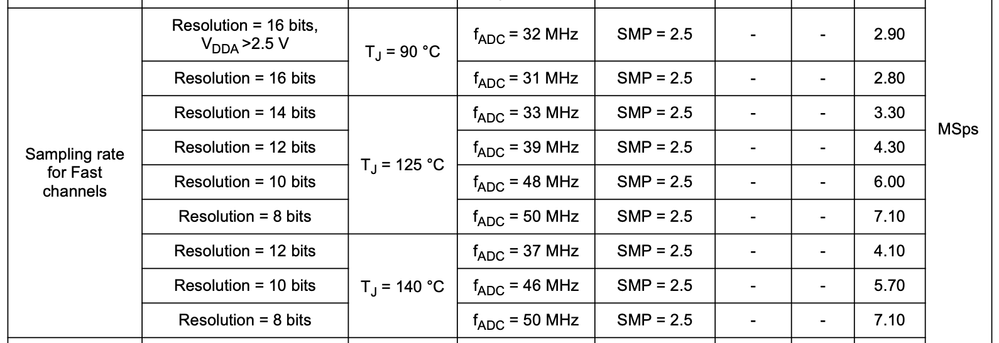

Thanks Bouraoui. I was hoping this is the case since the data sheet specifically lists such high clock speeds are required in order to maintain >3Msps operation:
