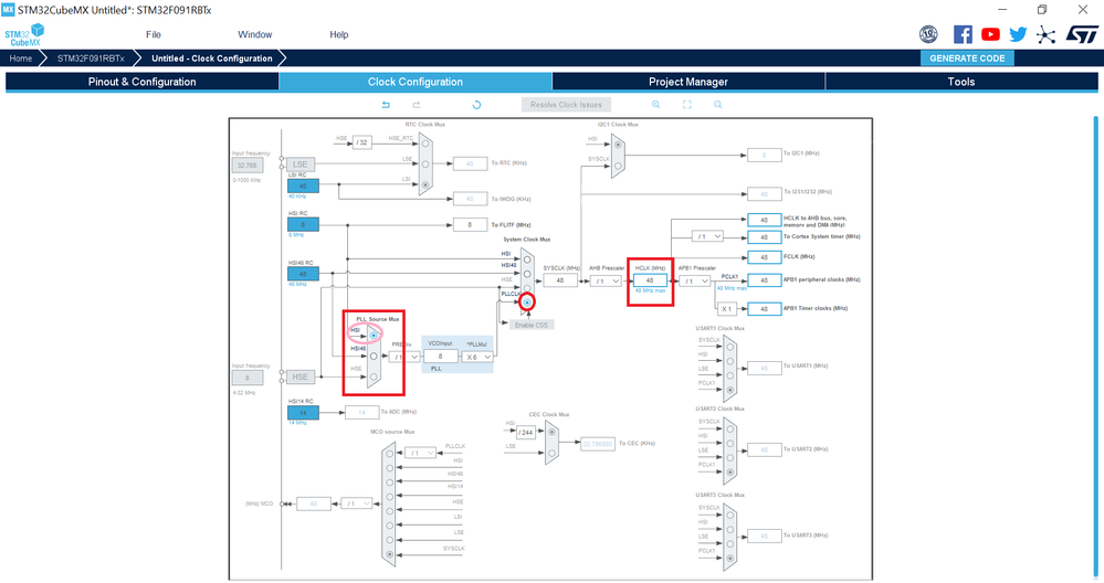

Hi @Mgawa.1​ ,
You can use STM32CubeMx software which is freely downloadable from ST official website.
Here is the code generated by CubeMX:
  * @retval None
void SystemClock_Config(void)
  RCC_OscInitStruct.OscillatorType = RCC_OSCILLATORTYPE_HSI;
  RCC_OscInitStruct.PLL.PLLSource = RCC_PLLSOURCE_HSI;
  RCC_OscInitStruct.PLL.PLLMUL = RCC_PLL_MUL6;
  RCC_OscInitStruct.PLL.PREDIV = RCC_PREDIV_DIV1;
    Error_Handler();
                              |RCC_CLOCKTYPE_PCLK1;
  RCC_ClkInitStruct.APB1CLKDivider = RCC_HCLK_DIV1;
  if (HAL_RCC_ClockConfig(&RCC_ClkInitStruct, FLASH_LATENCY_1) != HAL_OK)
    Error_Handler();
Best Regards,
Ons.

Hi @Mgawa.1​ ,
I meant you can use Mx for generating the Clock config only, and replace the generated code by Mx in your project.
This is how I did it:
  • I created a new project with STM32F091RBTx
  • I go to clock configuration tab and configured the clock as you suggested: HCLK = 48 MHz, SYSCLK source is PLL, and PLL source is HSI.
  • Finally I generate the project and copy the generated SystemClock_Config() function into my project.
This is really a simple and clean way to have a "correct" clock config that fits your preferences.
Best Regards,
Ons.
