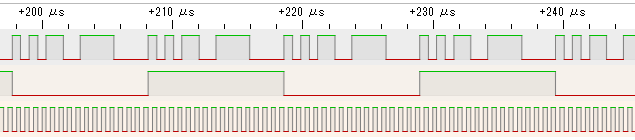

However, STM32F4 outputs a same signal twice.
For example, in this program, I put the I2S signal as "10101100111100001010110011110000...". But a output signal is "10101100101011001111000011110000..." like this image.
Please tell me how to solve this problem.

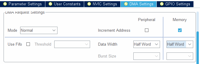

  1. In DMA configuration You have peripheral and memory data sizes set to byte, but with 16-bit data both of them should be half-word.
  2. HAL_I2S_Transmit_DMA function's 3rd parameter is data item count (total for both channels) not byte count.

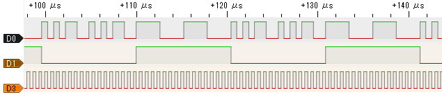

After changing a parameter to "Half Word", that signal was output as I expected. Thank you so much.
