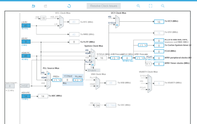

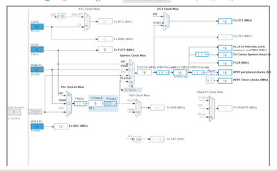

Thank for your fast reply Andrew,
This is the way i configured the project trying to run the microcontroller at 16MHz (this node is working as slave), but with this configuration i can't receive anything on the master. But if i change de HCLK frequency to 8MHz, all works perfectly.
With "it's not working" i mean that with 8MHz in HCLK the comunication works as i expect but if i put any higher frequency te comunication stops.

Also show your configuration for 8MHz ...
‎2024-02-05 2:04 AM - edited ‎2024-02-05 2:05 AM
Here it is:
‎2024-02-05 2:05 AM
Here it is:

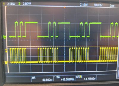

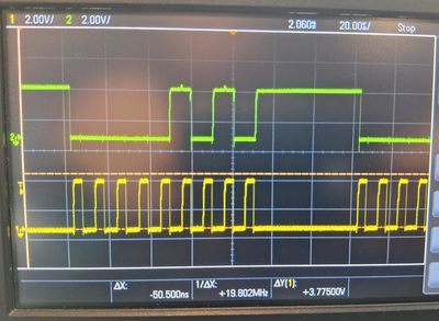

Also i've been able to see the signals in the scope and when I2C works (with HCLK set to 8MHz) they look pretty well, but when i upgrade the frequency (as i explained), SCL drops to 0V and SDA is pulled up.
I attach two pictures of the comunnication working, in green SDA, in yellow SCL.
