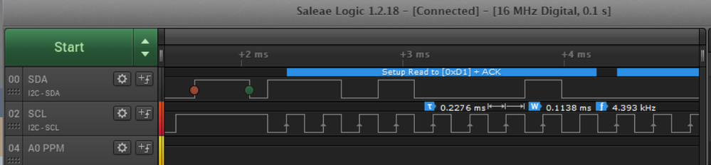

I2C SCL operating frequency is very low. I configured the I2C2 Interface of my STM32F103 to have a clock frequency of 100 KHz (standard Mode) but it turns out to only be around 4 kHz. Can you point me in the right direction as why this could happen?

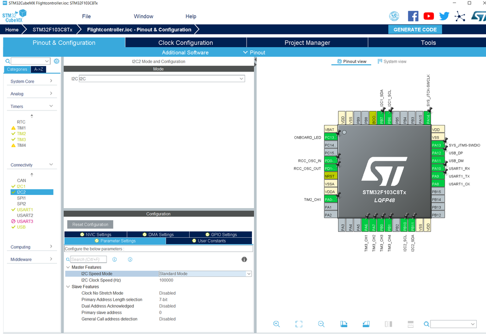

I am using the STM32F103C8T6 Microcontroller to read a sensor via I2C. I am using the stm32Cubemx to generate the initialisation code and Visual Studio and VisualGDB for debugging. My STM32CubeMX setup reads as follows:

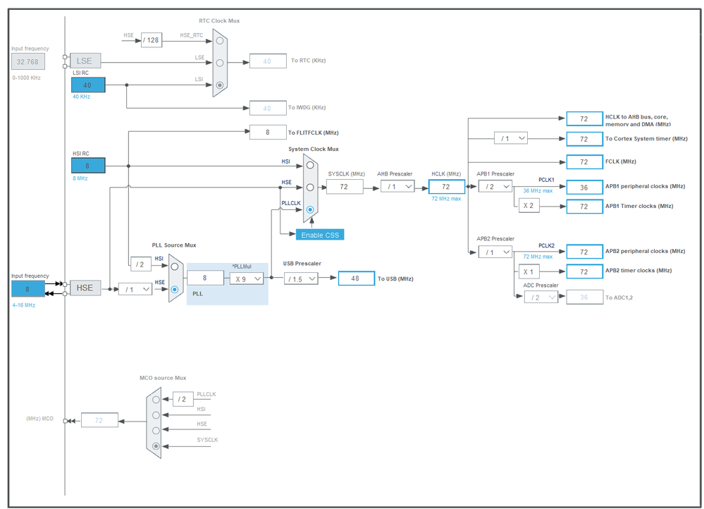

and my clock configuration:

It takes very long and my logic analyzer reports a SCL frequency of about 4.4kHz instead of 100kHz. I tryed using fast mode, too, but it behaves the same.

I have quite an amature setup and can't measure clock speeds that are beyond a few MHz. So I configured the hardware timer to give me a pulse of 1us based on the system clock (PWM Generation based on Internal Clock with Prescaler of 71 and CCR Register with value 1). The measured Signal is indeed 1us long therefore making me believe, that my system clock is clocked at 72 MHz.
