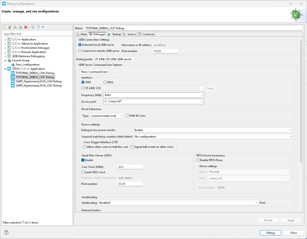

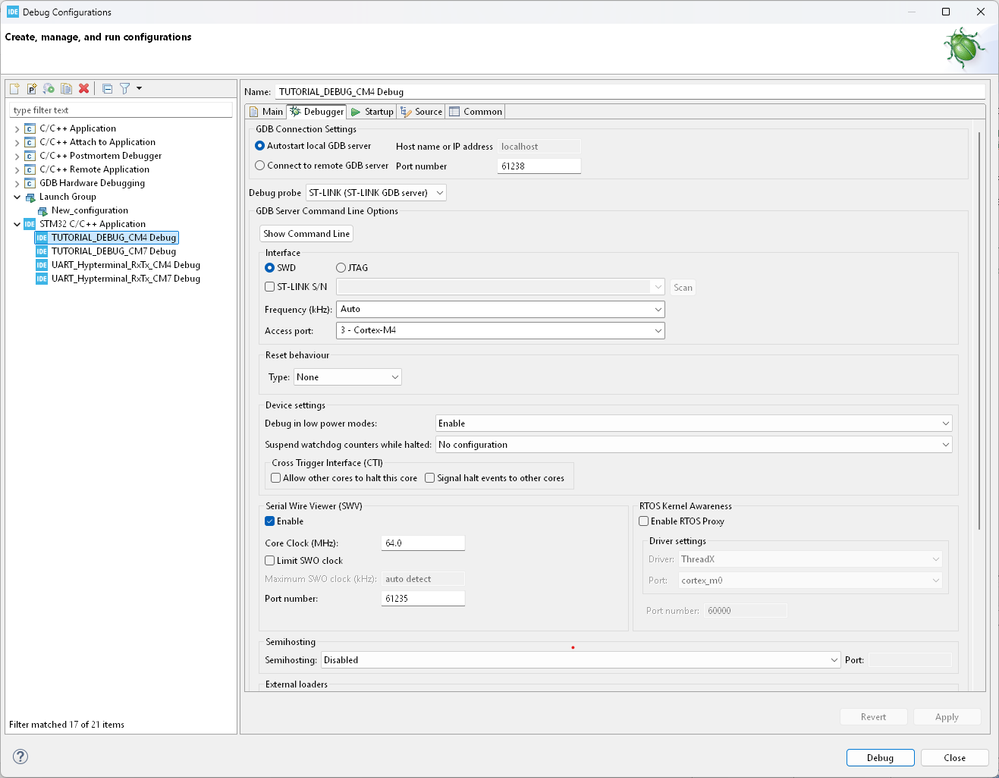

Here are the screenshots of the configuration I set up for STM32CubeIDE 2.0.0.
for the M7 debugger:
M7 DebuggerM7 Debugger
for the M4 debugger:
M4 DebuggerM4 Debugger
as you can see for M7 it is set to port 0, and the m4 to port 3.

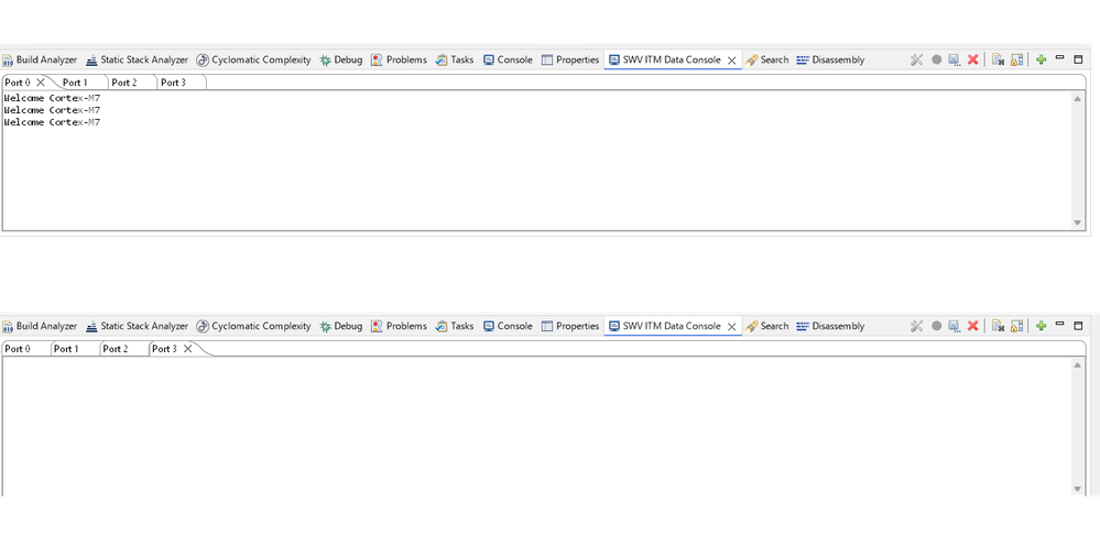

On the ITM console I see only port 0 of the M7 printing while port 3 on the M4 does not print anything, as shown in the screenshot below:
Port 0 on M7 and Port 3 on M7 is empty
ITM Data Console Port0 and Port3ITM Data Console Port0 and Port3
what's wrong?

Hello @Domy_ST
Actually, there is a limitation when using SWO in CM4 for STM32H755. Only one core's trace output can be connected to the physical SWO pin.
You can refer to this post Solved: Best practices for instrumentation logging with du... - STMicroelectronics Community, which provides a detailed explanation.
