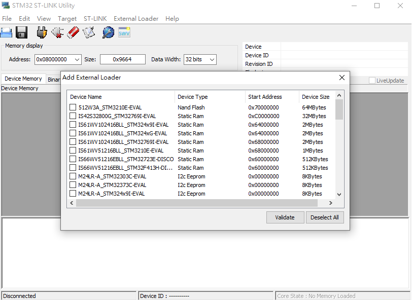

I use QSPI example can test this ,but I want do some image to external flash like this,my spi flash is W25Q256 is not in this list, how can I create it?

There are example sources/projects in [STM32 ST-LINK Utility]\ST-LINK Utility\ExternalLoader\, you can start by reading what's in these. Some of them are Cube-based, although not CubeMX. There's some rudimentary documentation in UM0892 (ST-LINK Utility UM.pdf) chapter 5. Note, that the functions are intended to be run from RAM, so it's important to observe the attached linker files. Also, they can't use interrupts, which makes things even a bit more challenging.
As an alternative to using STLinkUtility (or the Cube Programmer), you may be better off writing a simple application for your board, enabling to transfer data to be programmed e.g. through USART, using some simple protocol e.g. XMODEM.

The list only shows devices/boards for which custom loaders have been built.
The W25Q256 is not one ST uses, they predominantly use Micron/Intel due to the common ownership of IP and fab over the years.
Custom loaders can be built, but it is a paid help rather than free help activity.
