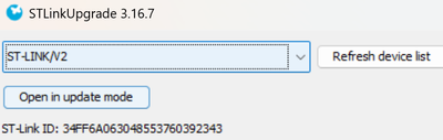

The font size used for the GUI in the STLinkUpgrade utility so small it is virtually unreadable on the external 32" 4K monitor that I use with my laptop. The following shows the text size relative to code within the IDE:

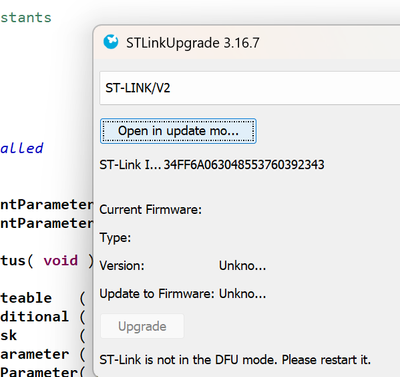

It's possible that this is as a result of using a 4K screen, as it looks ok when running on the laptop screen:
The size stays as above if I then close the lid, even though the external screen then switches back to 4K.

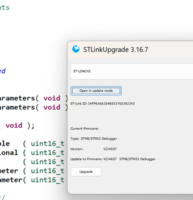

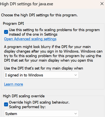

It looks like setting the following properties on java.exe in STM32CubeIDE\plugins\com.st.stm32cube.ide.jre...\jre\bin helps:
Though the UI text is a lot fuzzier than the window title (the difference doesn't show that well in the above).
Still, I can now see what I'm doing ;)
