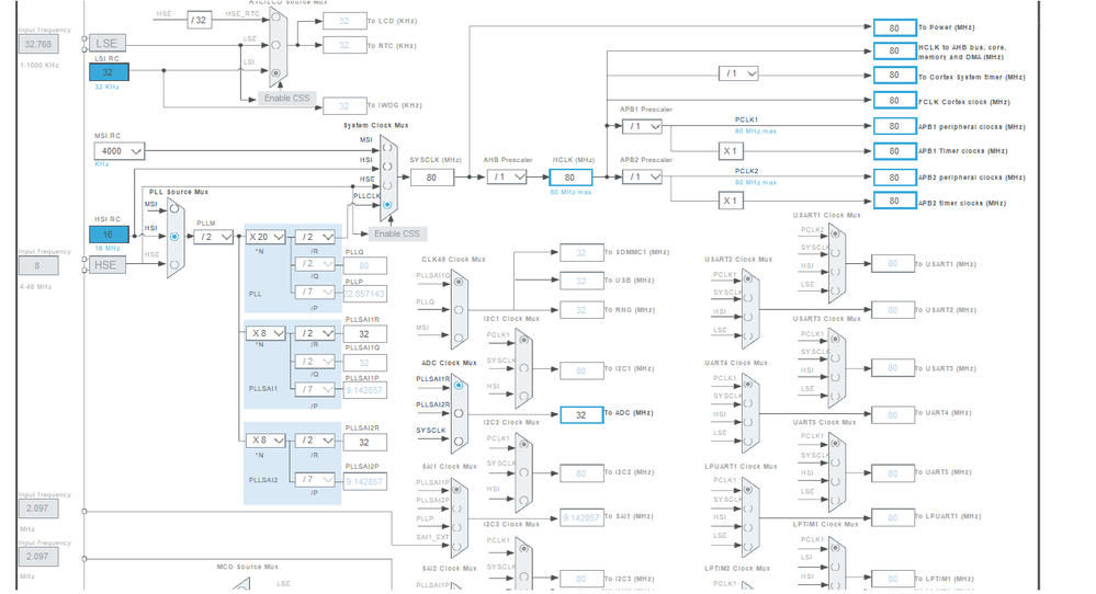

I'm a STMCube Newbie. I'm under the impression when I set up the clocks in STM32CubeIDE, it should generate all the clock configurations. Right now I'm not getting the RCC_PeriphCLKInitTypeDef PeriphClkInit = {0}; Should it be there. See clock config

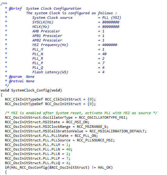

Your image is what I get. But I was expecting this as well:
void SystemClock_Config(void)
. // whats in your image plus vvvvvv
PeriphClkInit.PeriphClockSelection = RCC_PERIPHCLK_ADC;
 PeriphClkInit.AdcClockSelection = RCC_ADCCLKSOURCE_PLLSAI1;
 PeriphClkInit.PLLSAI1.PLLSAI1Source = RCC_PLLSOURCE_HSI;
 PeriphClkInit.PLLSAI1.PLLSAI1M = 2;
 PeriphClkInit.PLLSAI1.PLLSAI1N = 8;
 PeriphClkInit.PLLSAI1.PLLSAI1P = RCC_PLLP_DIV7;
 PeriphClkInit.PLLSAI1.PLLSAI1Q = RCC_PLLQ_DIV2;
 PeriphClkInit.PLLSAI1.PLLSAI1R = RCC_PLLR_DIV2;
 PeriphClkInit.PLLSAI1.PLLSAI1ClockOut = RCC_PLLSAI1_ADC1CLK;
 if (HAL_RCCEx_PeriphCLKConfig(&PeriphClkInit) != HAL_OK)
  Error_Handler();
What reference should I use on what to add to the generated code (like this) for other clock configuration details?.
