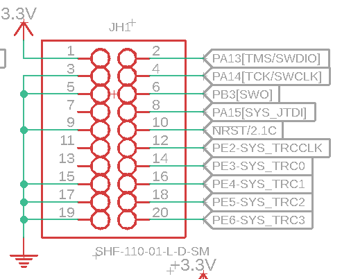

KSmel.1
I am using SWDIO and SWCLK and SWO for debug messages.
I had the 4 bits on JTag turned on for the I-Jet Trace on a 20 pin Jtag connector. How do I enable Trace in CubeMX?
Sara BEN HADJ YAHYA
Hello @KSmel.1​ ,
Please check section 7.3 in this AN4989 , you will find everything you are looking for.
I hope this helps :smiling_face_with_smiling_eyes: ,
Sara.
KSmel.1
Reading it Now. Thank-you
