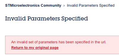

I saw similar issue in GitHub but it pertains to Source of fault.

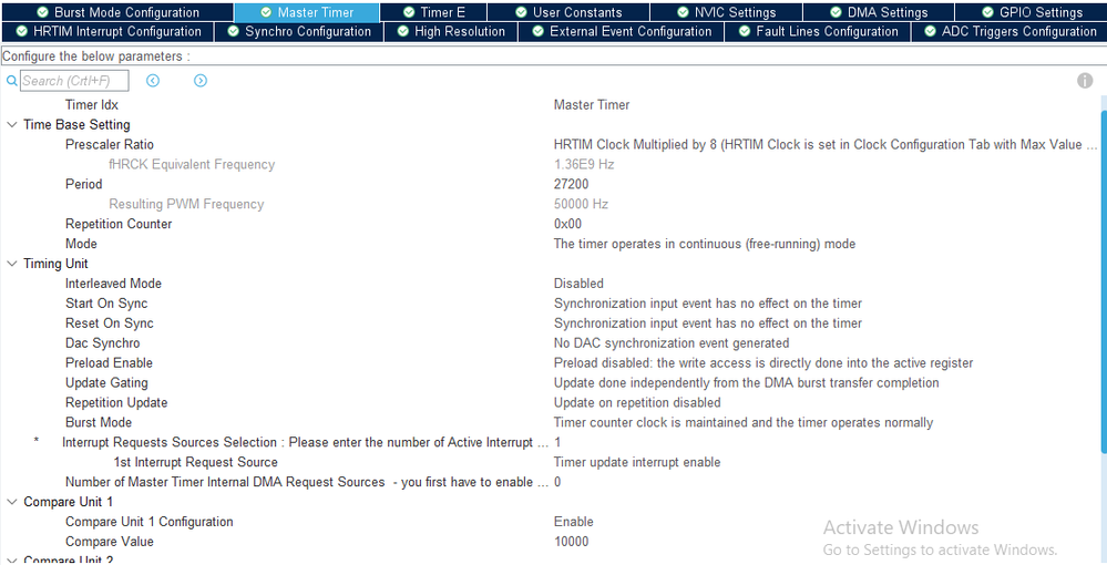

It seems that HRTIM-E1 will not fire up the interrupt unless I enable HRTIM-MASTER and its interrupt via CubeMX.

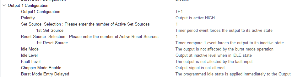

Here is the setup of HRTIM-E1:

  pTimerCfg.InterruptRequests = HRTIM_MASTER_IT_MREP;
  pTimerCfg.DMARequests = HRTIM_MASTER_DMA_NONE;
  pTimerCfg.DMASrcAddress = 0x0000;
  pTimerCfg.DMADstAddress = 0x0000;
  pTimerCfg.DMASize = 0x1;
  pTimerCfg.HalfModeEnable = HRTIM_HALFMODE_DISABLED;
  pTimerCfg.InterleavedMode = HRTIM_INTERLEAVED_MODE_DISABLED;
  pTimerCfg.StartOnSync = HRTIM_SYNCSTART_DISABLED;
  pTimerCfg.ResetOnSync = HRTIM_SYNCRESET_DISABLED;
  pTimerCfg.DACSynchro = HRTIM_DACSYNC_NONE;
  pTimerCfg.PreloadEnable = HRTIM_PRELOAD_DISABLED;
  pTimerCfg.UpdateGating = HRTIM_UPDATEGATING_INDEPENDENT;
  pTimerCfg.BurstMode = HRTIM_TIMERBURSTMODE_MAINTAINCLOCK;
  pTimerCfg.RepetitionUpdate = HRTIM_UPDATEONREPETITION_ENABLED;
  pTimerCfg.ReSyncUpdate = HRTIM_TIMERESYNC_UPDATE_UNCONDITIONAL;
  if (HAL_HRTIM_WaveformTimerConfig(&hhrtim1, HRTIM_TIMERINDEX_MASTER, &pTimerCfg) != HAL_OK)
    Error_Handler();
  pCompareCfg.CompareValue = 5000;
  if (HAL_HRTIM_WaveformCompareConfig(&hhrtim1, HRTIM_TIMERINDEX_MASTER, HRTIM_COMPAREUNIT_1, &pCompareCfg) != HAL_OK)

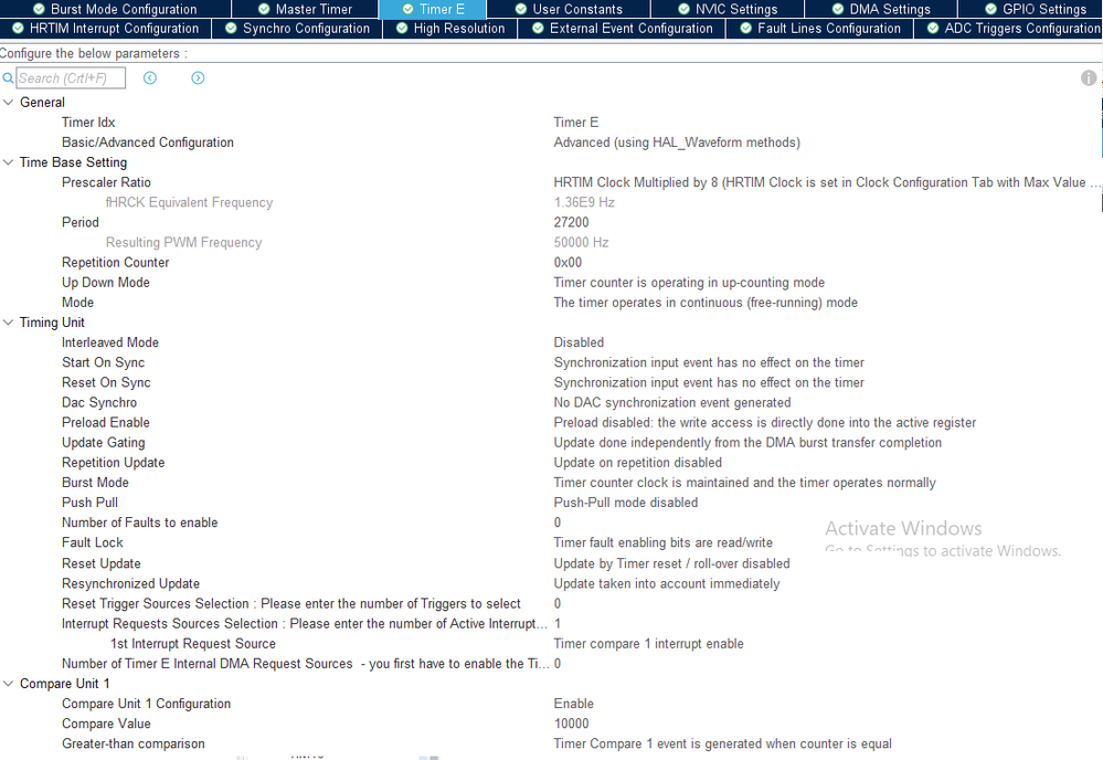

  if (HAL_HRTIM_TimeBaseConfig(&hhrtim1, HRTIM_TIMERINDEX_TIMER_E, &pTimeBaseCfg) != HAL_OK)
    Error_Handler();
  pTimerCtl.UpDownMode = HRTIM_TIMERUPDOWNMODE_UP;
  pTimerCtl.GreaterCMP1 = HRTIM_TIMERGTCMP1_EQUAL;
  pTimerCtl.DualChannelDacEnable = HRTIM_TIMER_DCDE_DISABLED;
  if (HAL_HRTIM_WaveformTimerControl(&hhrtim1, HRTIM_TIMERINDEX_TIMER_E, &pTimerCtl) != HAL_OK)
    Error_Handler();
  pTimerCfg.DMARequests = HRTIM_TIM_DMA_NONE;
  pTimerCfg.RepetitionUpdate = HRTIM_UPDATEONREPETITION_DISABLED;
  pTimerCfg.PushPull = HRTIM_TIMPUSHPULLMODE_DISABLED;
  pTimerCfg.FaultEnable = HRTIM_TIMFAULTENABLE_NONE;
  pTimerCfg.FaultLock = HRTIM_TIMFAULTLOCK_READWRITE;
  pTimerCfg.DeadTimeInsertion = HRTIM_TIMDEADTIMEINSERTION_DISABLED;
  pTimerCfg.DelayedProtectionMode = HRTIM_TIMER_D_E_DELAYEDPROTECTION_DISABLED;
  pTimerCfg.UpdateTrigger = HRTIM_TIMUPDATETRIGGER_NONE;
  pTimerCfg.ResetTrigger = HRTIM_TIMRESETTRIGGER_NONE;
  pTimerCfg.ResetUpdate = HRTIM_TIMUPDATEONRESET_DISABLED;
  if (HAL_HRTIM_WaveformTimerConfig(&hhrtim1, HRTIM_TIMERINDEX_TIMER_E, &pTimerCfg) != HAL_OK)
    Error_Handler();
  pCompareCfg.CompareValue = 10000;
  if (HAL_HRTIM_WaveformCompareConfig(&hhrtim1, HRTIM_TIMERINDEX_TIMER_E, HRTIM_COMPAREUNIT_1, &pCompareCfg) != HAL_OK)

  pOutputCfg.Polarity = HRTIM_OUTPUTPOLARITY_HIGH;
  pOutputCfg.SetSource = HRTIM_OUTPUTSET_TIMPER;
  pOutputCfg.ResetSource = HRTIM_OUTPUTRESET_TIMCMP1;
  pOutputCfg.IdleMode = HRTIM_OUTPUTIDLEMODE_NONE;
  pOutputCfg.IdleLevel = HRTIM_OUTPUTIDLELEVEL_INACTIVE;
  pOutputCfg.FaultLevel = HRTIM_OUTPUTFAULTLEVEL_NONE;
  pOutputCfg.ChopperModeEnable = HRTIM_OUTPUTCHOPPERMODE_DISABLED;
  pOutputCfg.BurstModeEntryDelayed = HRTIM_OUTPUTBURSTMODEENTRY_REGULAR;
  if (HAL_HRTIM_WaveformOutputConfig(&hhrtim1, HRTIM_TIMERINDEX_TIMER_E, HRTIM_OUTPUT_TE1, &pOutputCfg) != HAL_OK)
    Error_Handler();

in CubeMX
Period to set the IO and COMP1 to reset it
I have the output, but it will not enter the interrupt.

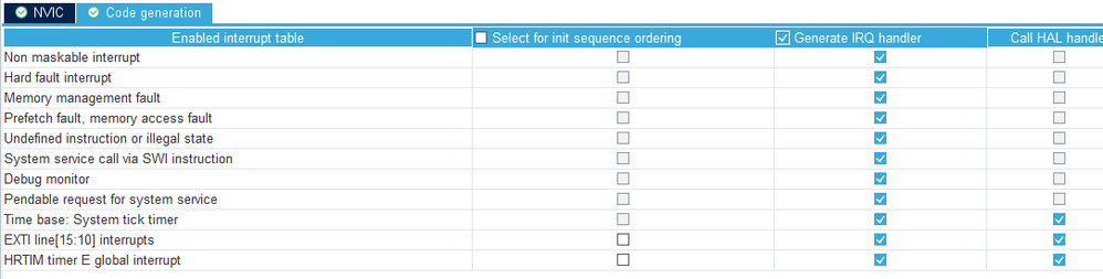

I use another I/O to check whether it entered or not.
void HRTIM1_TIME_IRQHandler(void)
  /* USER CODE BEGIN HRTIM1_TIME_IRQn 0 */
	GPIOC->BSRR = (1<<11); // start
  /* USER CODE END HRTIM1_TIME_IRQn 0 */
  HAL_HRTIM_IRQHandler(&hhrtim1,HRTIM_TIMERINDEX_TIMER_E);
  /* USER CODE BEGIN HRTIM1_TIME_IRQn 1 */
  GPIOC->BSRR = (1<<(11+16)); // end
  /* USER CODE END HRTIM1_TIME_IRQn 1 */
If I enable MASTER HRTIM but disable NVIC call handler
void HAL_HRTIM_MspInit(HRTIM_HandleTypeDef* hhrtim)
  if(hhrtim->Instance==HRTIM1)
  /* USER CODE BEGIN HRTIM1_MspInit 0 */
  /* USER CODE END HRTIM1_MspInit 0 */
    /* Peripheral clock enable */
    __HAL_RCC_HRTIM1_CLK_ENABLE();
    /* HRTIM1 interrupt Init */
    HAL_NVIC_SetPriority(HRTIM1_TIME_IRQn, 0, 0);
    HAL_NVIC_EnableIRQ(HRTIM1_TIME_IRQn);

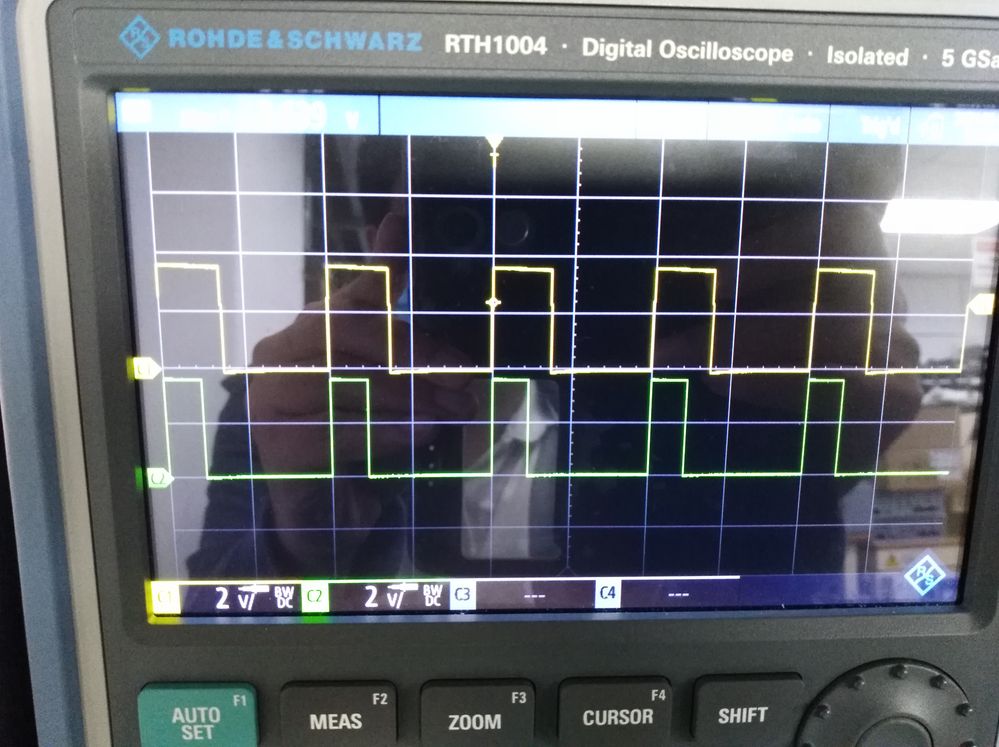

The interrupt would fire up as shown below.
CH1 yellow = HRTIM-E1
CH2 green = PC11
What's more troubling is that the postion of the interrupt would depent on the HRTIM MASTER interrupt source.
In this case, CMP1 and repetition will fire up HRTIM-E1 (but not "timer update").
Also CMP1 of HRTIM-E1 will be used in case CMP1 as the source for HRTIM-MASTER.
2 REPLIES 2
Would you mind posting the answer? The link you posted doesn't work. All I get is this:
