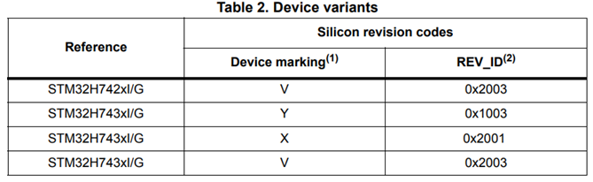

This is not enough! you also need to check the errata sheet. In fact, there is the following limitation :
480 MHz maximum CPU frequency not available on silicon revision Y ( product STM32H743xI)
Errata sheet  STM32H743 : Errata sheet - STM32H750xB STM32H753xI - STM32H750xB and STM32H753xI device limitations
There are 3 revisions:
Description
VOS0 voltage scaling level is not available on silicon revision Y devices.
This limits the maximum CPU frequency to 400 MHz.
Workaround
Use silicon revision V devices to reach a maximum frequency of 480 MHz.

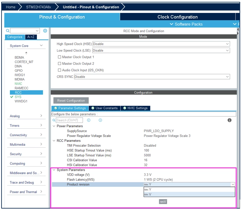

Open STM32CubeMX and create a new project for STM32H743xI/G.
  • Now from the tab “RCC” select the revision V:

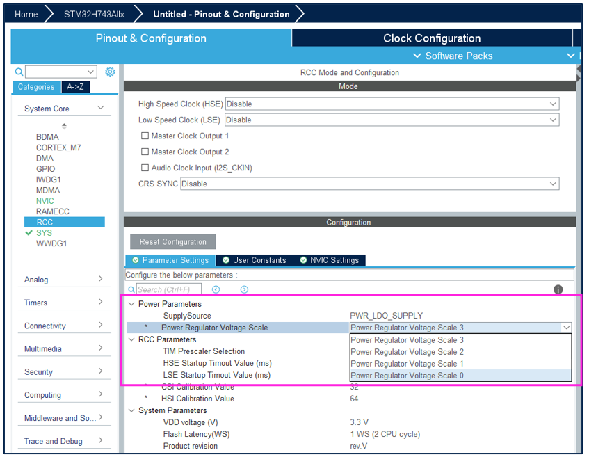

  •   Change the Power Regulator Voltage Scale to Power Regulator Voltage Scale 0:

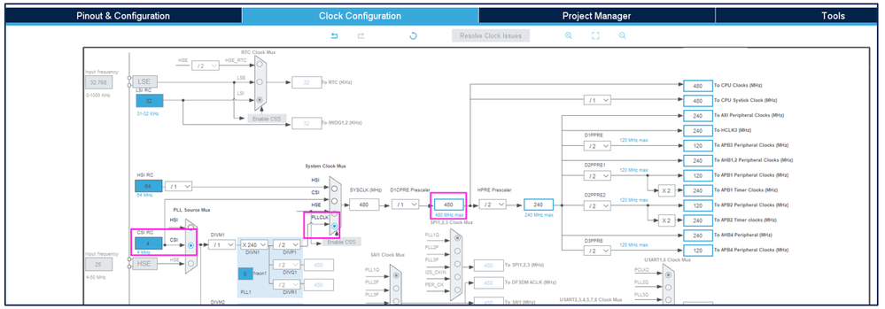

  • Select the “Clock Configuration” tab:
Now all you have to do is use any of your application code with 480MHz on system clock.
